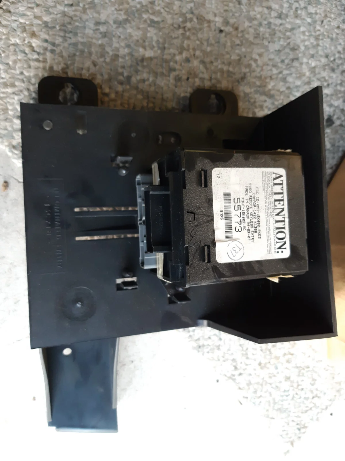

Thank you for the tip on the Keyless Entry Module!! I had the same issue with my 95 GT. Fuse 8 kept blowing. No Radio, no speedometer, no dome light, no power locks etc. The car had an aftermarket stereo when I bought it so knowing that it was on the Fuse 8 circuit I started there. No luck. Removed the stereo and the aftermarket CD player that was below it. Next I moved onto searching for a bare wire. Another discussion mentioned that the printed board on the back of the gauge cluster could be the problem. Removed the gauge cluster, fuse 8 still blowing. Read your thread about the Keyless Entry Module. Found it on the driver's side in the trunk behind the carpeting. Removed the 2 large push retainers and the small one on the rear wall and got it free enough to pull the 3 plugs out. There I saw the infamous light green with yellow stripe wire that seems to run everywhere from fuse 8. Anyway, pulled all 3 connectors and put in a new 10A fuse in #8. It did not blow!! Now I have to begin the reassembly of everything, but that is OK. At least I know what it was and can get it corrected. Hate electrical gremlins!! Thank you again for sharing what you found.

So my 94 Gt convertible did the exact same thing. No speedometer, dome, radio, clock and the doors would only lock. Keyfob no longer worked either. Fuse #8 blown and kept blowing. I checked the Keyless entry module as Promustang50 and MikeW70 did and you could smell the smoke. Its unhooked now and everything is working again except my dome and door locks. My concern is did it just go out due to age or did something cause it to burn out. There are no new keyless entry modules available for it. Can anyone give me the wiring diagram for it and what exactly runs through it? I'm going to try replacing it with a used one but was considering installing an aftermarket with car alarm in its location because all the wires I need are there. Just need that wiring diagram. Appreciate and help
