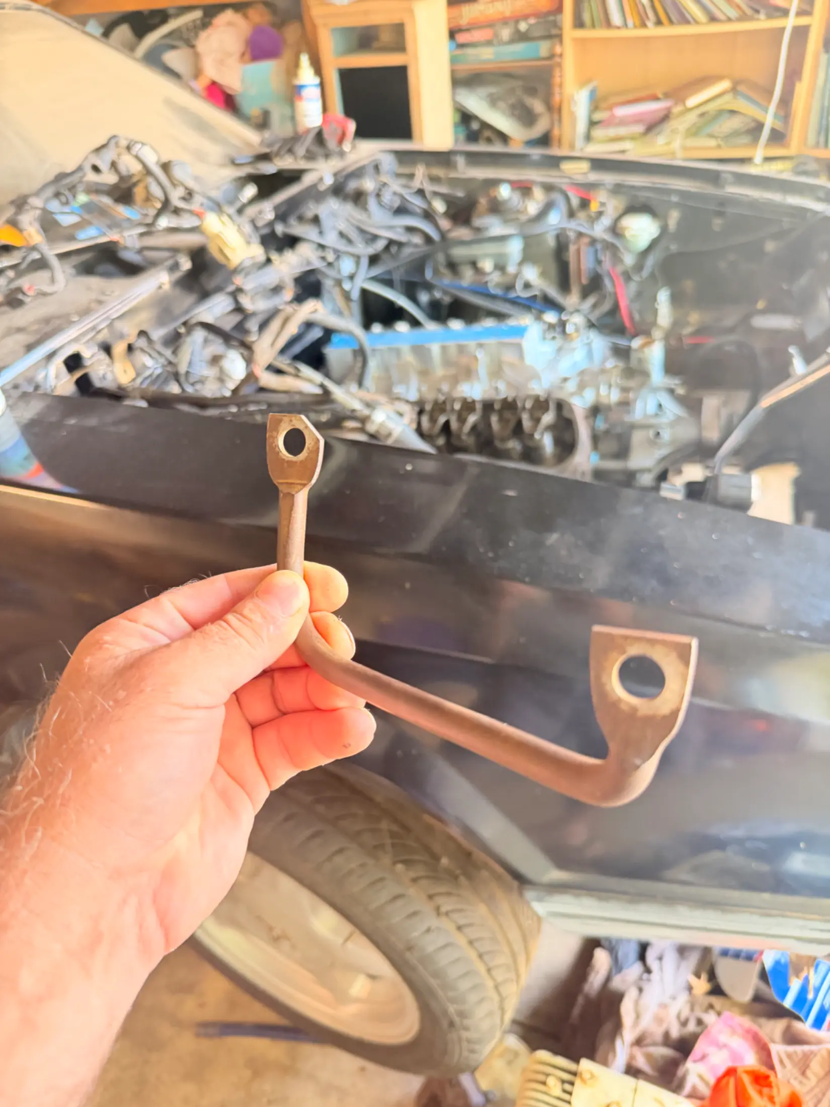

I’ve just refreshed my 91 lx 302. I have the engine back in the car and am in the process of hooking everything back up. I don’t remember what this is. Any help would be greatly appreciated.

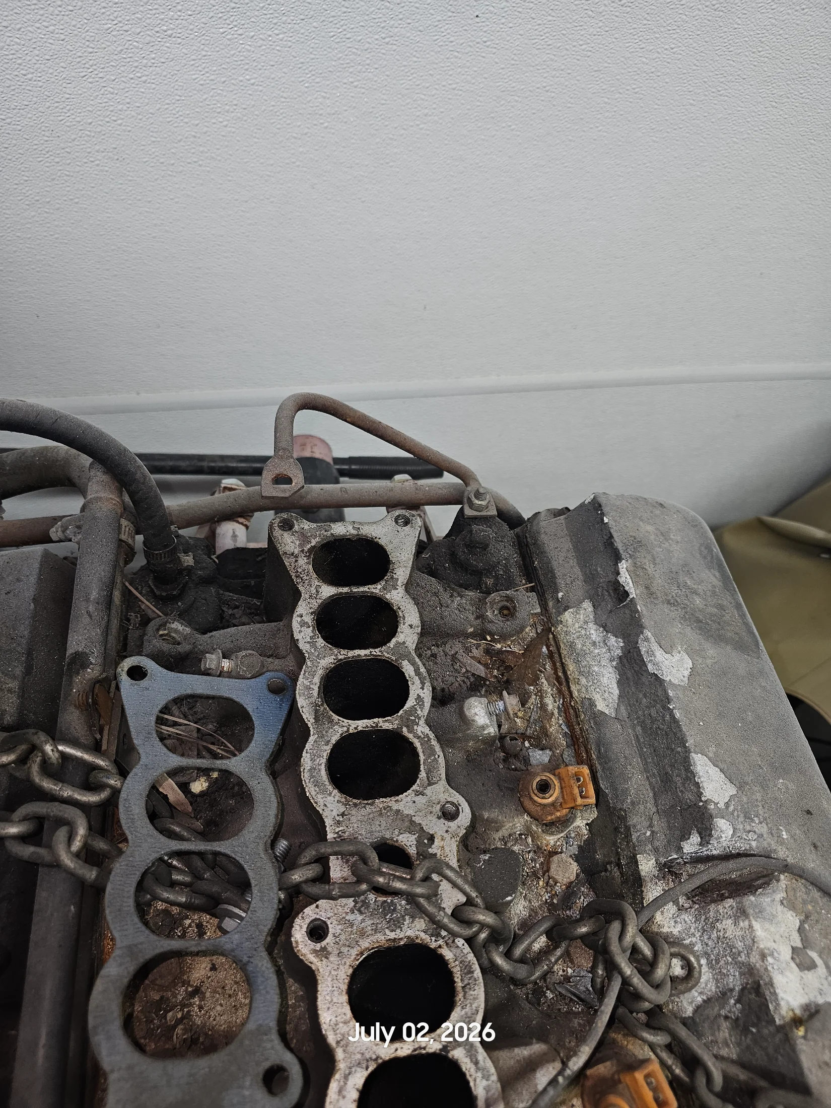

Welcome to :SN: !
Right off the bat, to answer your question, it's a support bracket for the upper intake manifold plenum. Here's where it mounts on the lower, it should be evident where it goes on the upper. ;)
