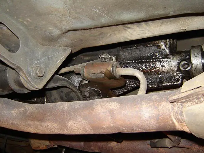

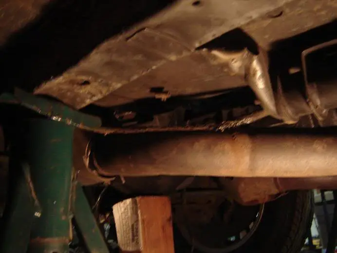

could this effect why my speedometer is off by 20mph?
it is hard to see but that wire is burnt and melted from the exhaust pipe. Is that even the speedo wire?

TRWXXA said:
How fast do you think you were going? If the error is caused by an incorrect speedo gear, your speedo is going to be off by a percentage, not just "20mph". If it were off by 20mph, it would say 20mph while you're stopped (if that's the case then you have a broken speedometer).
If you think you were doing 70mph, and your speedo was reading 90mph (37% error), that would be consistent with a 2.73 to 3.73 gear swap. If you think you were doing 40mph, and the speedo said 60mph (a 50% error), that would be consistent with a 2.73 to 4.10 gear swap.
yea it was a percentage off. and I think i was actually going 70 when it said 90. Does this mean it is the rear end gears and not the speed gears??
A common cause for a big speedometer error is non-stock rear gears. A lot of people will change the rear end ratio, and forget to change the speedometer gearing to compensate. The speedo is just counting the number of revolutions the transmssion's output shaft makes for each mile driven. With a higher rear end ratio, the transmission has to turn the driveshaft more revolutions per mile. The speedo senses this as a faster speed. Non-stock tire sizes will have a similar, but much less drastic, effect.
The tranny has two speedometer gears in it -- a "drive" gear on the output shaft (hard to change), and a "driven" gear on the speedometer cable (easy to change). You need to reduce the number of times the speedo cable turns per mile. You do this by increasing the number of teeth on the "driven" gear on the end of the cable.
The number teeth on the "driven" gear you need to get depends on the year of your car, the rear end gear ratio, and what tranny you have.
Follow the suggestions above to see if you can determine which drive gear is inside your speedo.
Like someone said above, check your rear end to see if the factory tag is still on there. It would be held on by one of the cover bolts. If the tag is still there it usually means the diff hasn't been opened up, and it should say the gear ratio on the tag.
There's a pretty good chance that your speedo is off because your transmission was replaced by a different year with the different drive gear.
Once you figure out which drive gear your tranny has, and what ratio your rear end gears are, then you can figure out which speedo gear you need to get your speedo accurate again.
