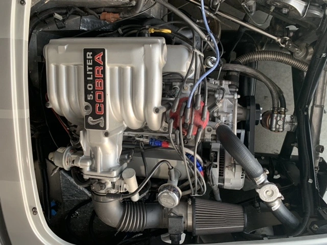

There is no overheating/temp gauge relationship to the eecv computer. There is a cold start thing between the computer and temp sensor, not to be confused with the temp sender, sensor is for the computer, mounts into the heater tube or intake on front passenger side and has two wires (no relationship to the gauge) the sender is for the gauge and mounts in the intake on the drivers side and has one wire (no relationship to the computer).
There is on newer computers not ours though.
... There is a cold start thing between the computer and temp sensor, not to be confused with the temp sender, sensor is for the computer, mounts into the heater tube or intake on front passenger side and has two wires (no relationship to the gauge) the sender is for the gauge and mounts in the intake on the drivers side and has one wire (no relationship to the computer).
i was going to say this but saw you edited your post before i could.
To OP:
In your picture i don't see the ecu temp sensor, because you don't have the heater tube anymore. Has this been moved to a different location? Or was just it just completely left out on accident?
Reactions: General karthief
That's not the ECU temp sensor. That's the sender for the gauges. ECU sensor installs on the pass side of the motor in a boss in the lower intake. Usually a heater tube comes out of that.
I do see 24# injectors. What MAF and ECU are you running?
From the pic, nothing else stands out as a potential cause. Lets see what you get for codes when you run them. If the ECU is easily accessable, can you get the 3-digit code off it?

The only real details I know about the build are the bullet points I put up top. 24 pound injectors are stock correct?
19# is stock.
Prob not the source of your problem, but the stock ECU won't run them without a tune (chip) or with a calibrated MAF which I can't tell if that is.
This may not be the source of the problem, but it might be something to look into.

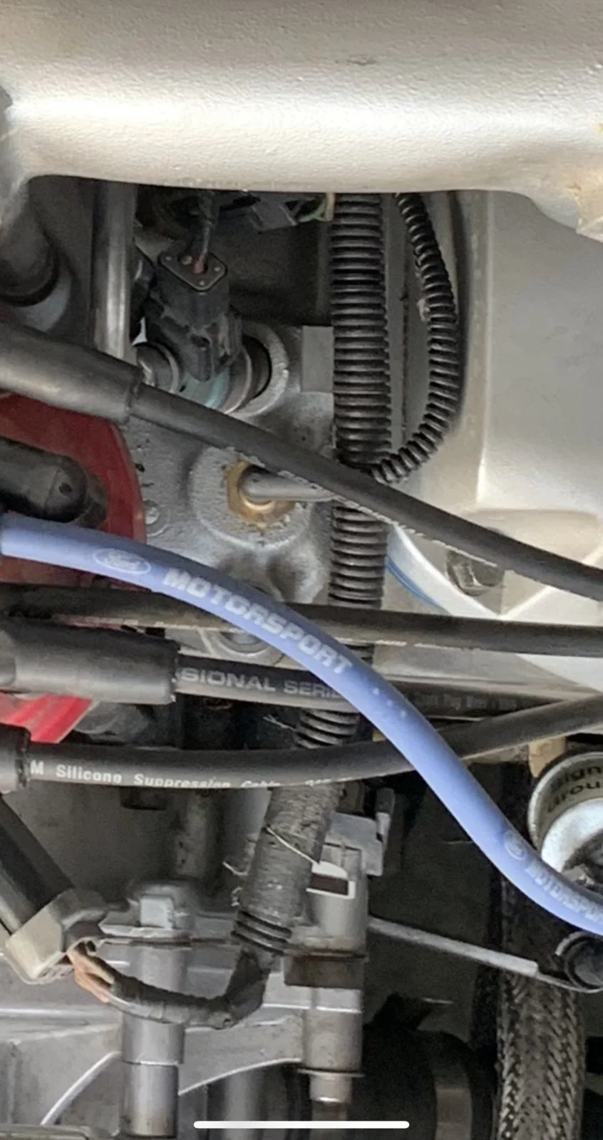

can you get me a picture of the passenger side of the engine looking from front to back centered around the lower intake . Or just look for the lone connector for the ecu temp sensor. It almost looks like an injector plug in size.
24lb were stock on the 93 cobra. If the temperature sensor is missing it will cause the car to run in closed loop all the time. The sensors really wouldn't start talking...like the o2 sensors. Usually, it would also lead to a rich condition out the tail pipe.
