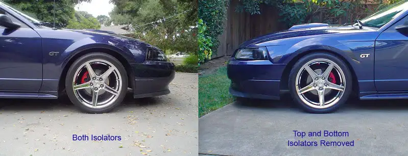

doesw any body have pics with isolators and without?

for me, removing mine did NOT create any extra noises than there already were. no creaks or vibrations. If you do decide to remove the isolators, i'd recommend wrapping the ends of the spring that touches the spring seat in electrical tape. For my car, i just cut out some rings of thin rubber toolbox liner just as a precaution against any noises.

I removed the fronts top and bottom recently and there are no squeaks from removing it. I hit a major bump/pothole though and it crashed a lot harder than it used to. That's a trade off I can live with for now as it looks so much better IMO. I might eventually go with H&Rs and put back the ISOs in the future if finances allow.
