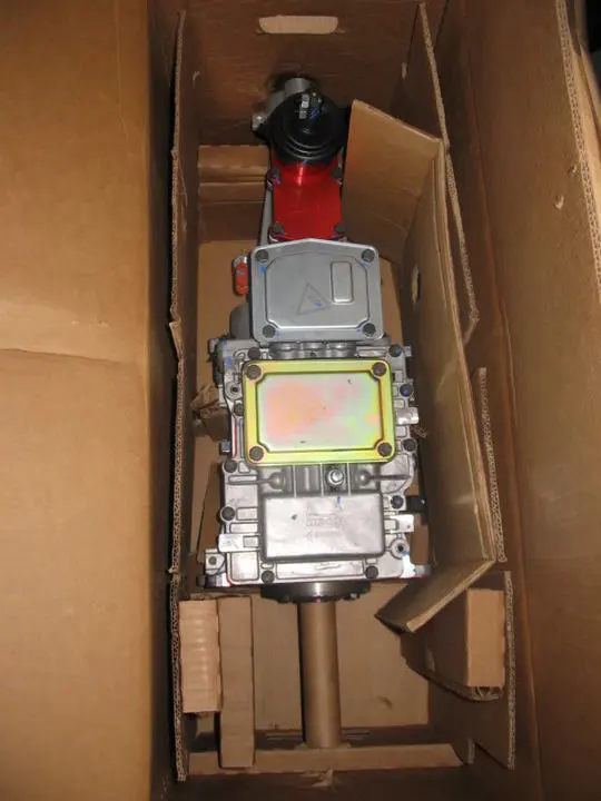

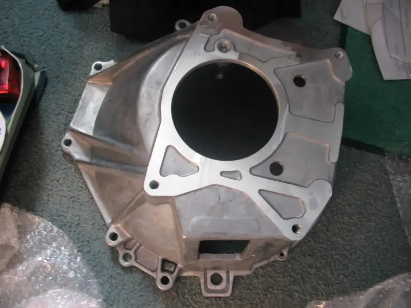

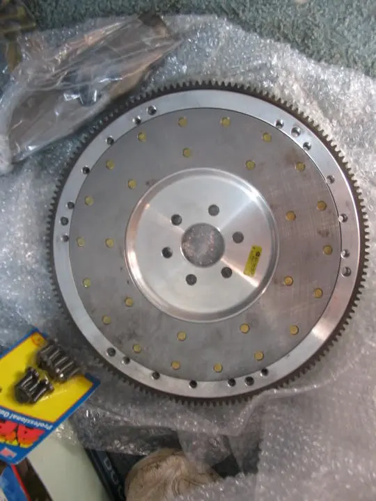

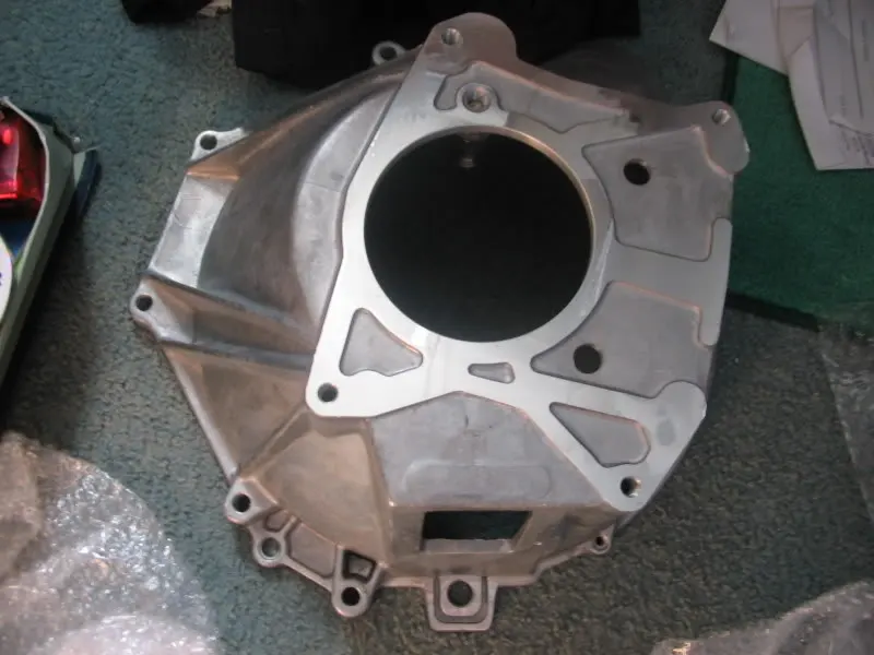

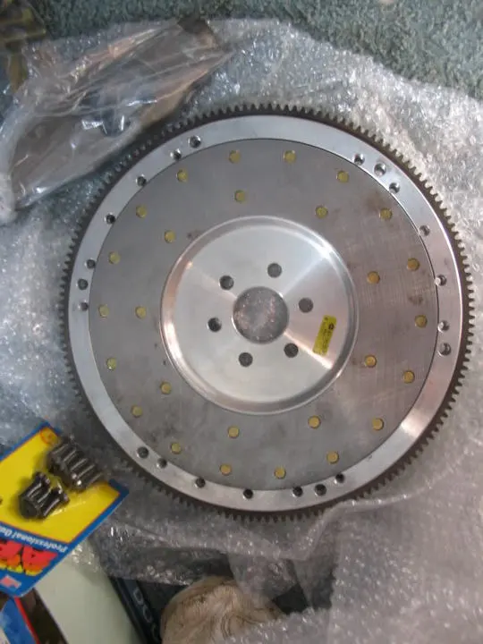

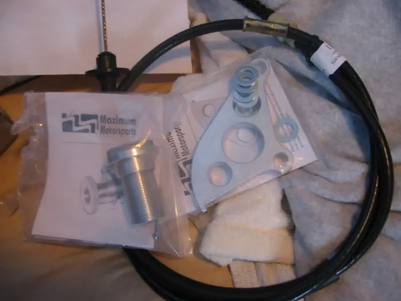

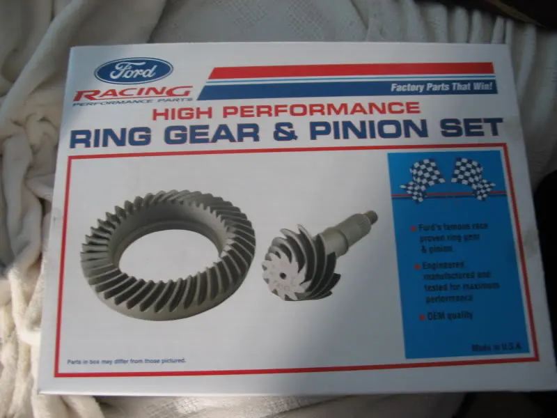

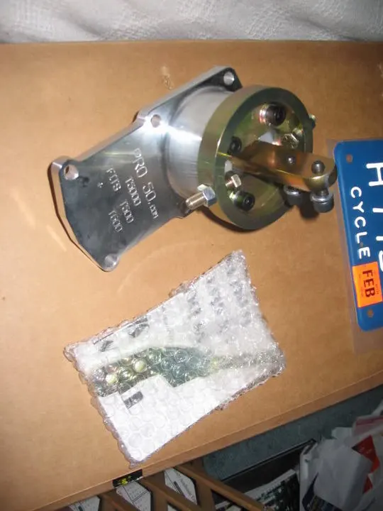

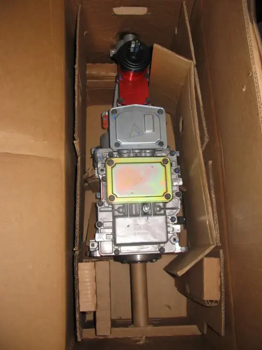

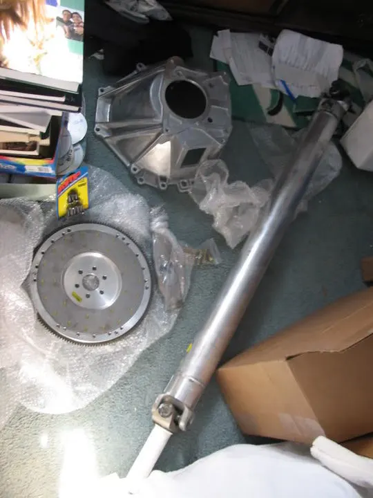

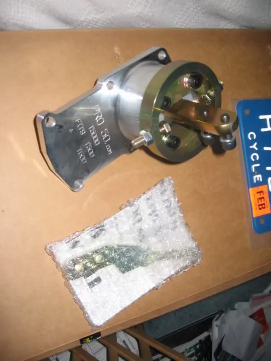

Things have finally started to come in so I figured I'd start snapping pictures:

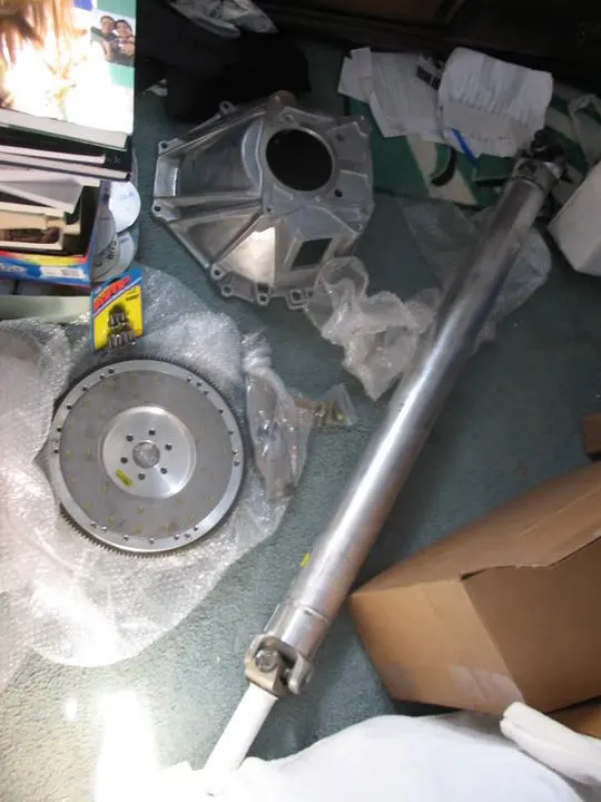

I got pretty much everything through www.bieberfever.com and I am trying out a few things that seem to go against the grain of what everyone else has done with this TKO swap. When I got the DS I got one for 96+ cars, which already comes with the 31 spline slip yoke on it so I didn't have to buy it separately, and I'm not running a spacer. They said that the slip yoke is longer than the ones on our cars and that there is plenty of contact area. They also said that when you add the spacer you are changing the pinion angle and that's why many people have vibrations.
However, I am no expert so I'll be the guinea pig on this and let you guys know how everything works out.
Other than that, my clutch, smog delete, and a few misc. bolts and such will be coming in this week too. The only thing I need now is some warmer weather to get rid of this dang snow!

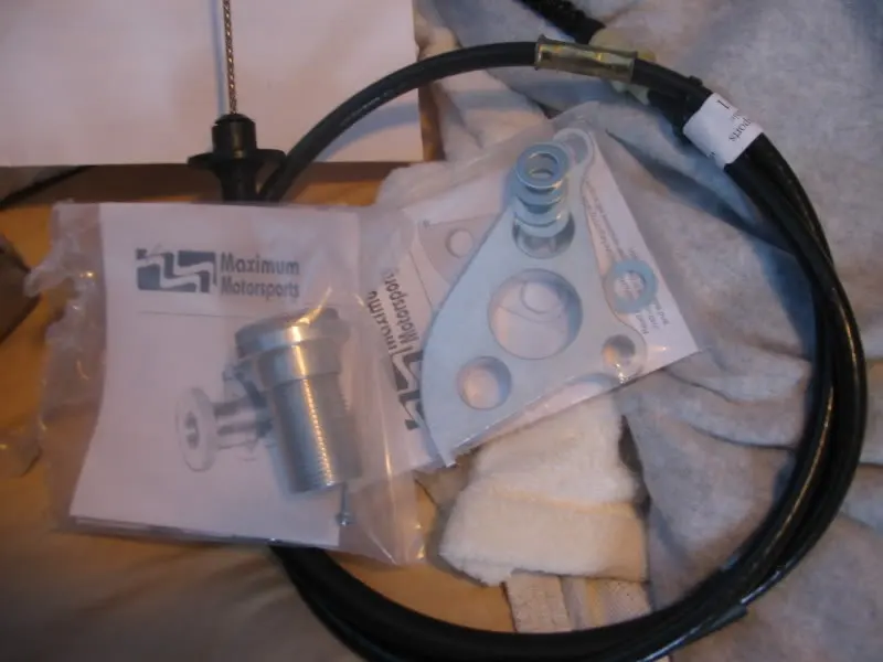

that looks exactly like my garage haha... did they send you an offset mount for that so that you don't have to modify the crossmember?
Actually, they said they don't have an offset mount (which confused me because someone on here pointed me to them for that reason?), do you know of a place that sells one, it's really the last thing I'm looking for.
