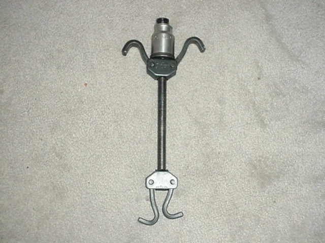

Any tips on doing this (on a 65)? If I put the compressor in and crank it down the rod bottoms out on the perch and binds it. If I put it in with the nut side down I can't get at the nut.
Is there an easy way to do this? I'm thinking of putting a double nut on the top but I'm not sure how well that will work?

You can use the internal compressors but you need to add a ton of washers to compensate for the short travel of the spring. The washers will go between the top of the top hooks and the end of the "bolt". Just a couple of notes.....DO NOT use an impact wrench and make sure you stay CLEAR of the spring. No matter what tool you use if it loosens up just a little it will pop and cause some damage. You also need to be sure you jack up the front of the car so you have less to compress.

The external compressors are dangerous, I use
the internal one from NPD, but I use a 3/4 drive socket as a spacer to keep the rod from bottoming out. NO problems and I've done it many times. The external ones are like a time bomb waiting to go off. That ford factory tool looks great, but notice there is no uppper control arm installed. The one you have would be just as easy without the control arm or spring perch in the way

Ok now I'm more confused than ever, the internal finger type is quite the nightmare to get set in the first place and removing it is no picnic either, and that's without it even working at all because of bottoming out on the spring perch. How is a 3/4" drive socket going to change that, doesn't it just get crushed into the spring mount the same way?
Surely there must be a safe way to remove a spring. I have no idea how the Ford tool or the knock off works but I'm willing to try it if I can find a supplier that sells it. The external type did work and I'm still alive but I'd like to keep it that way

The subject was "Spring Removal". If the control arm wasn't installed, the spring would already be out and he wouldn't be bottoming out on the spring perch, until he tried to install the arm. I don't know who Mr. Glazier is, and I was not implying that he didn't know what he was doing. Just that it's a lot easier with the whole front end disassembled.
I am the original owner of a 68 cj mustang and have raced it from day one and still do. I worked as a ford technician From 1961 to 1984.
The 3/4 drive socket was only used as a spacer, but a section of pipe or anything else will work
