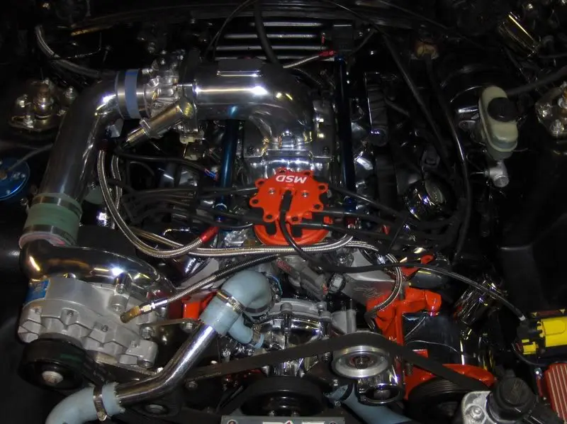

I am running the 302 spyder on my supercharged 331. i was told they are great intakes on cars with blowers. i have no info on na motors. well they look good anyway.
