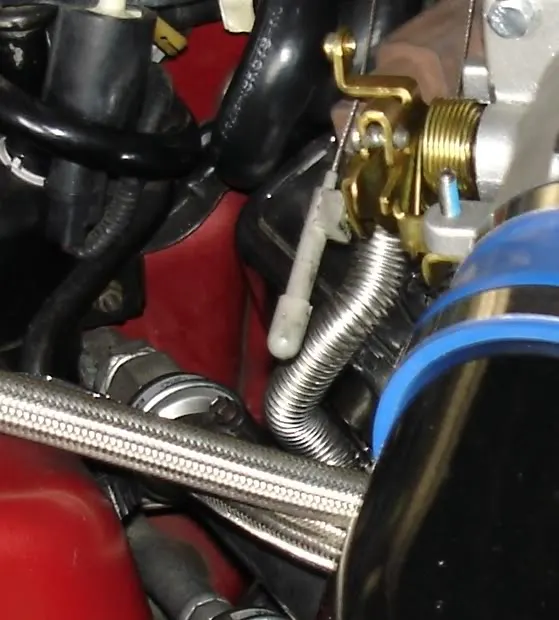

All I know is that the size of those threads is metric, nothing standard. In order to use some natural gas flexible SS tubing, I had a metal shop cut off and weld on new standard sized bungs for $20.

Do you have any pictures of your setup? How is the tubing standing up to the heat?

This is the best shot I got, you can't see the bungs, but you can see the material of the tube.
That's before I ever started her up. Its holding just fine 4,000 miles later, just discolored from the heat, that's all.
