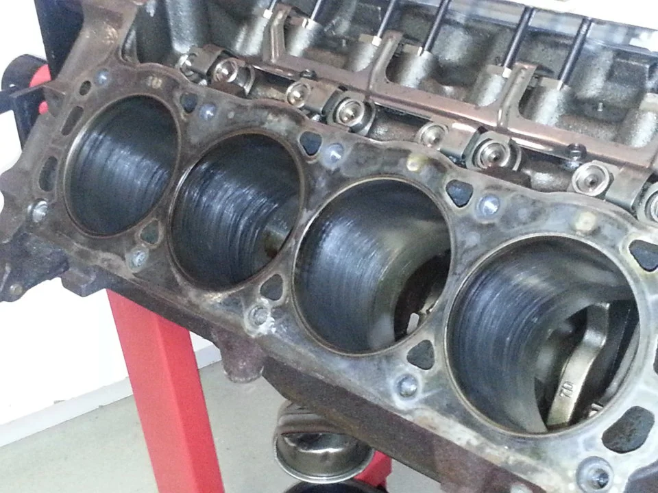

that also involves more money. Machine work plus new pistons and rings. Its just the standard bore.
It can easily snowball money wise. Trying to do it simple and cheap. Love to do the aftermarket long block but that is a lot of cash.
Worked on the cylinders today. Deglazed 4 of them.
Also found a lifter that I have to replace. Chunk missing off the top edge.
that pic was after I broke the glaze. Those scratches help hold onto some oil. When the cylinder is glazed it has difficulty holding onto some oil. There are some light vertical scratches in there from the pistons.
