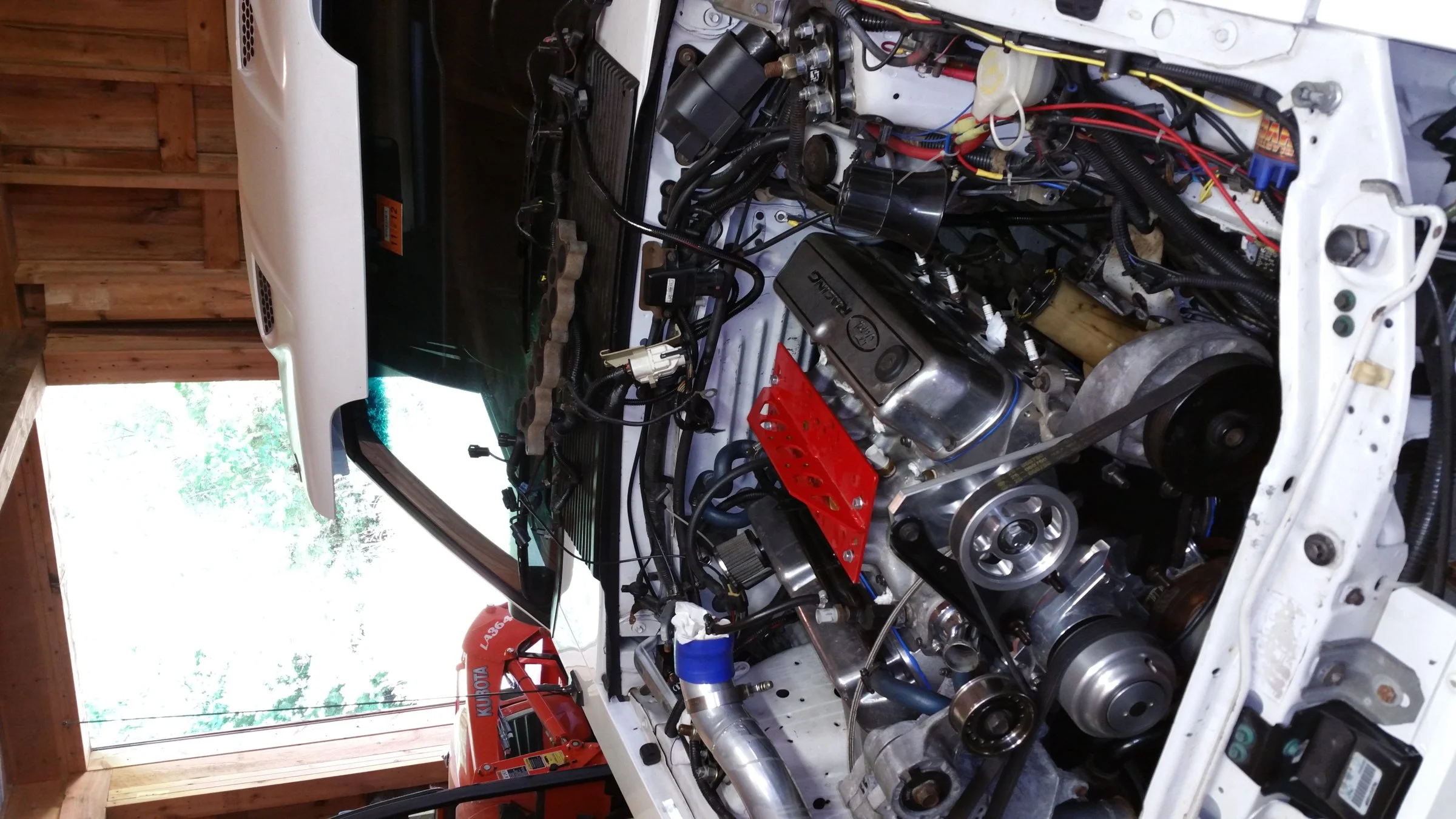

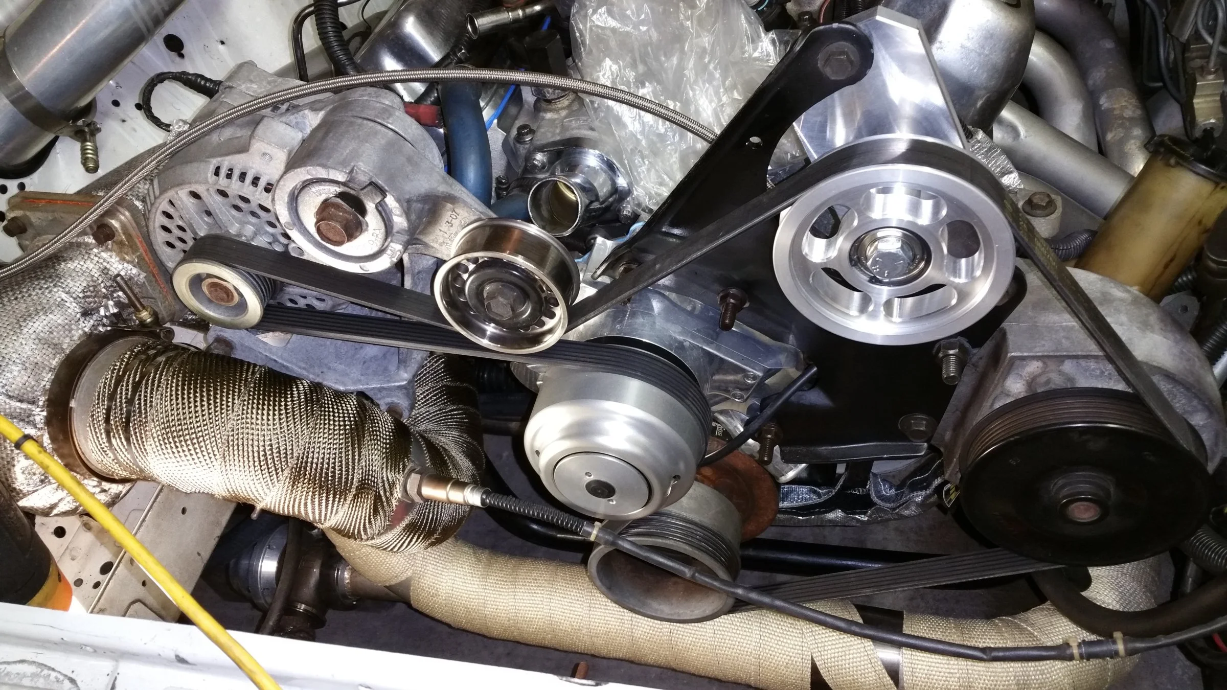

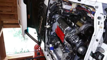

Made just a little more progress this weekend. Wrapped a couple of the big exhaust pipes to cut down on radiant heat hitting the wiring and other things. Also wrapped the battery cable going to the starter. Installed the starter which involved removing the K member brace. Today I filled the engine and trans with oil. Got some new plugs and a drain tube for the turbo.
Next couple of things I have to do would be install the upper plenum and reinstall the power steering cooler that I removed when I put the turbo kit on. Also need to drain the fuel that is several years old. Bunch of little things.
Reactions: Dan_Soprano
Draining the gas took some time. The fuel pump doesn't stay on when you turn the key on. Was hoping since it wasn't building pressure in the rail that the pump would keep running. I would have had to hook up a jumper wire somewhere to get the pump to stay on constantly. So instead I cycled the key off and on. It took cycling the key about 35 times to get 1 gallon of fuel out. I pumped out over 8 gallons over a couple of days.
I primed the oil pump and have everything hooked up. Right now I have a new rubber shifter boot ordered because the original is rotted away.
I think all that I have to do is put in fresh fuel and try to fire her up.
