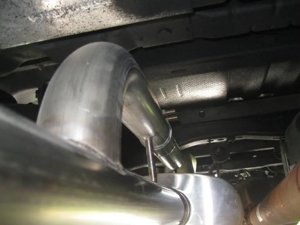

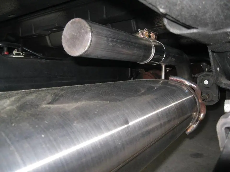

i installed a straight through Magnaflow on my truck. it had a bad drone around that seemed to peak around 1800 RPM (when up to temperature). I made my own closed end resonator and made it adjustable so I could tune it to the exact frequency range. I've made various lengths and also diameters to test the impact. So I know it works.
