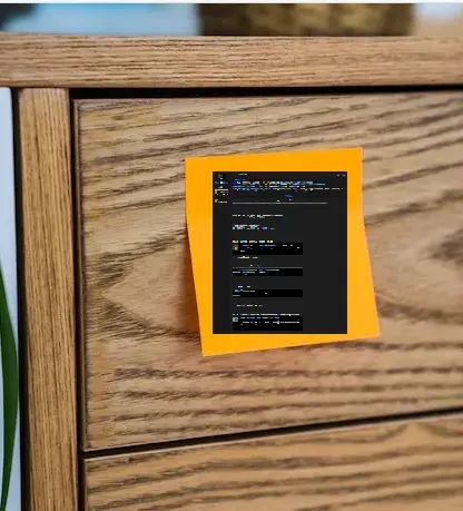

What your posts would look like with some line breaks and subjects separated. It allows the site to parse all of your links.
