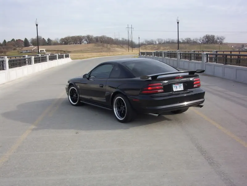

Mine with stock springs on 18x9 2000 Cobra R wheels.

Stockers:

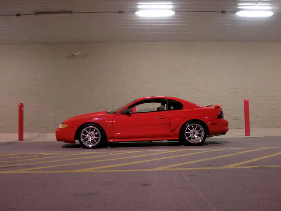

My car is dropped on Sportlines/AGXs, full poly everything, c/c plates and the works
I run 275s UP FRONT with a 285 in the rear (and I want to go 305s)
I BARELY rub at all at full opposite lock and only when turning right due to the angled down splash panel on the drivers side.

^that's H/C/I stance too after taking @ 40lbs off the nose. No smog, car retains factory A/C

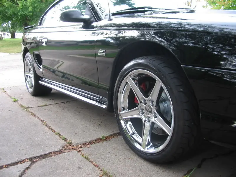

ok, here's some pictures of my car.

Sorry, not sure why the pics won't get bigger.
