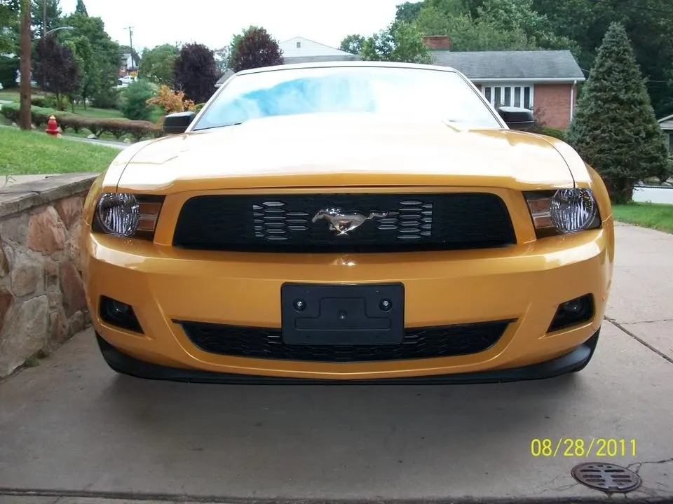

Sorry for the delay.
Here is a pic....it really looks stock.
The directions are very clear and easy to follow....maybe conbtact Starkey and see if they will send a PDF of them?
Pricey, but there is something to be said for ease of install and OEM fog light looks.
