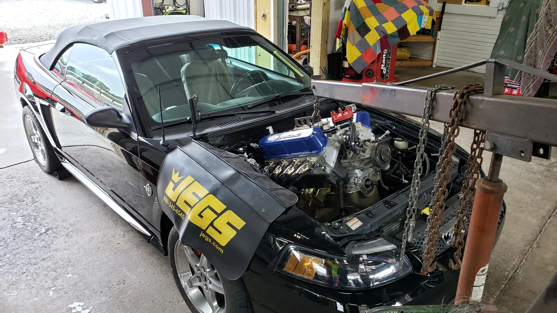

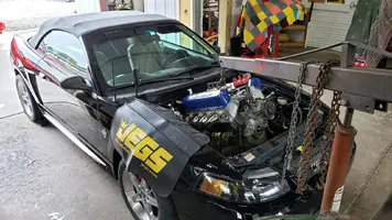

I bought my vert v6 about 6 years ago because i wanted a clean slate... it was exactly that, never hot rodded, never wreaked because it was just that... a v6
But i bought it with the plan of putting a v8 in it and coverting to a manual
About 3 years later i got around to it and its a blast now, and everything was perfect to work on, except the brakes... i have no clue what the oem brake lines were, but they were impossible to flare cold, hot or annealed.
The ABS module was the only thing about the v6 model that was a pain, so i just ran all new NiCop lines and that solved all the issues
I voewed as a chance to get a clean car for a project for little cash, who wants a v6 mustang new edge... they are slow, poor millage and no resale... swap was my reason
And it was perfect
