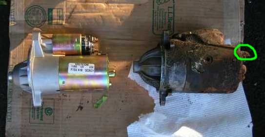

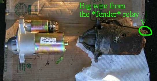

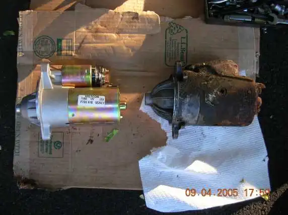

If they put on a new type of starter, and hooked it up incorrectly, then it would do exactly what you said.
See what type of starter you have. You can tell by if there are one or more wires going to the starter, and if there's a relay on the top of the starter.
Here are some pictures:
Uhm, the old/original style is the dirty starter, and the new style is the new starter.

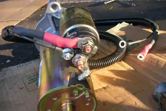

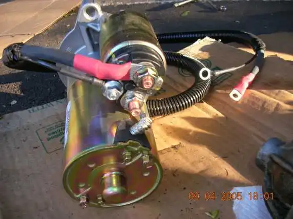

Here are the install instructions for the Ford min-starter:
http://www.fordracingparts.com/download/instructionsheets/FordInstShtM-11000-A50A75B50B75.pdf
From the instructions: (Bold and caps is their format.)
! ! ! WARNING: DO NOT INSTALL A JUMPER WIRE BETWEEN THE BATTERY TERMINAL AND THE SOLENOID BLADE TERMINAL AT THE STARTER TO AVOID THE USE OF THE # 12 WIRE. IF DONE, VOLTAGE IS GENERATED TO THE SOLENOID BY THE STARTER SPINNING AFTER THE RELEASE OF THE START KEY OR BUTTON, CAUSING THE STARTER TO REMAIN ENGAGED, RESULTING IN SEVERE DAMAGE AND EVENTUAL FAILURE OF THE STARTER ! ! !
Mine looks like the starter on the left one of the new style starters and its hooked up right, ive done it twice.
So, you have it such that:
1) The big/fat wire on the starter's relay is always live with +12V.
2) On the relay/solenoid on the fender, you have a big terminal (the one that's switched) with only the small wire that goes to the relay on the starter.
Just about any other way, and you'll have the starter "act like a generator" and produce electricity while it's turning which will activate the starter's relay until the current draw kills the relay. Note that many electric vehicles, and some newer gas engines, use a combo integrated starter/alternator. There's no magic, no hand waving, just standard electro-magnetic theory.

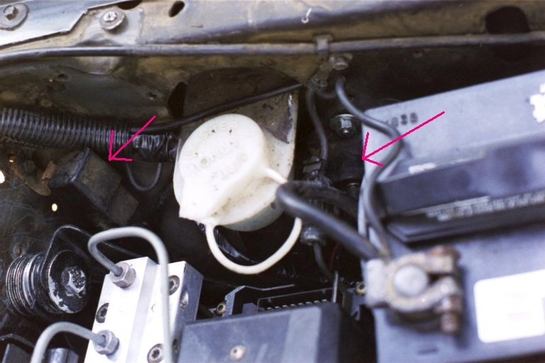

Here's an old picture of where my fender relay/solenoid is now. But, that was also before I put in the mini starter. The fender relay/solenoid is near the arrow on the right.

Take a picture of the fender relay/solenoid.
I don't think that you can post a direct link yet with your number of posts (min 50 needed?). You can also PM me the link to the picture.
