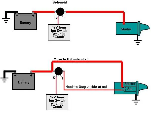

You may have a stuck solenoid or the wire that is supposed to be coming from the start side of the ignition switch somehow got switched with a battery or ignition sourced wire.
1. Check your battery voltage. It should be stay between 10-12volts while cranking.
2. Disconnect the wire from the "S" terminal (left small wire) and check to make sure that wire coming from the Ign switch only has voltage when cranking. If good hook it back up.
3. Disconnect the 12 gauge wire off from the right side of the solenoid (going to the starter) and check to make sure that the terminal only has voltage when cranking. The solenoid should click closed while turning the key to start. If good, hook the starter wire back up.
4. Try it now.
Here are a couple threads on wiring Mini Starters:
http://forums.stangnet.com/763810-starter-solenoid-problem.html
http://forums.stangnet.com/667850-mini-starter-wiring.html
Here is a diagram before (with a standard starter) and after with a ministarter:
Here is how I did mine. I replaced the fender mounted solenoid with a standard Bosch type relay mounted (behind the firewall).
