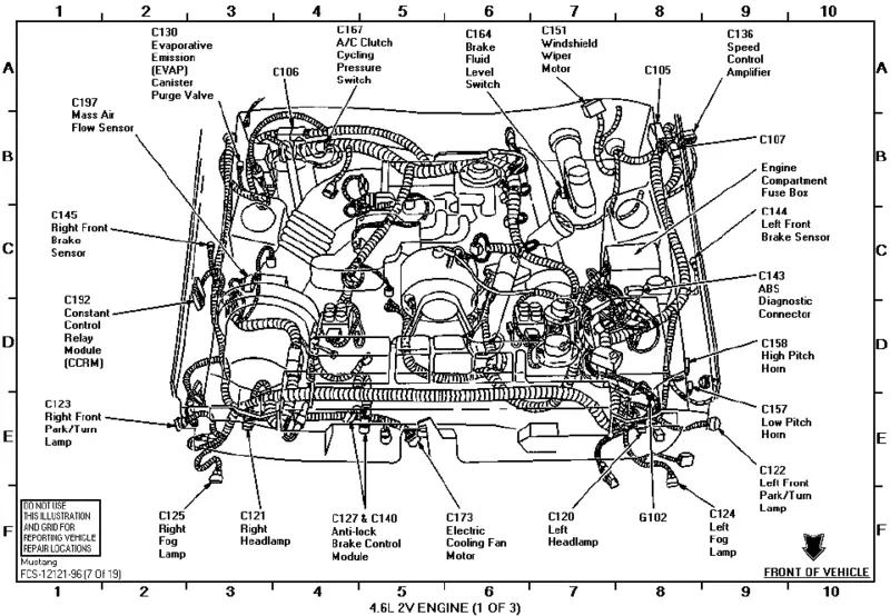

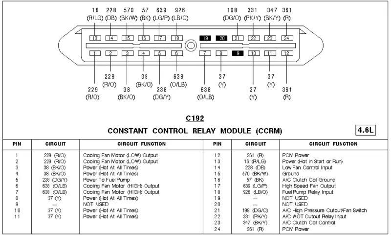

Run the pump by jumping it at the (ccrm)Constant control relay module connector 192 in the diagram below, by jumping pin 11-yellow wire and pin 5-dark green and yellow wire.
