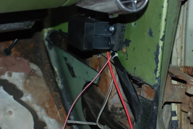

I bought a painless wiring harness with 3 constant power leads and 4 switched power leads. Shown here:

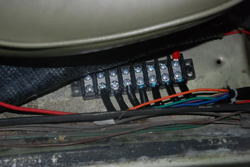

These leads go to a terminal block next to the passengers seat shown here:
Now, the leads I have coming off the terminal block are
-Switched power for the 6AL
-Switched power for a cooling fan for the 6AL
-Switched power for Taurus fan controller
-Constant 12V for Taurus fan controller
-Constant 12V for electric choke
The fuse block requires a switched power connection and a lead that runs to the battery. The painless kit says to "piggy back" off the old fusebox for switched power. Now the pink wire/resistor connects to the old fusebox right? Well instead of piggy backing off the old fusebox or just connecting directly to the ignition switch, I ran the pink wire (thats the wire running off the painless fusebox) to an aftermarket 30 amp relay and a 10AWG wire running from the same side of the relay to the starter solenoid. On the other side of the relay I attached a wire running to the ignition switch and then one to ground. Hence when the ignition is 'on' the relay closes and I get my switched power directly off solenoid.
So after that lengthy response I can't see how the pink resistor wire would influence my new circuit. Am I correct or am I a complete dolt?
Thanks guys, and any feeback on my circuit setup is welcome.

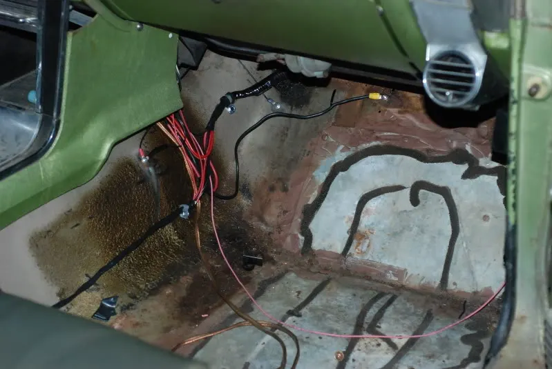

Also here is a picture of sort of the whole passenger floorboard:

I like your painless accessory power distribution. So the pink wire is probably not an issue, but I think you should try to track down why there is only 1.5 volts at the MSD box. Trace it back and see what components it has to pass through and check along the way.
