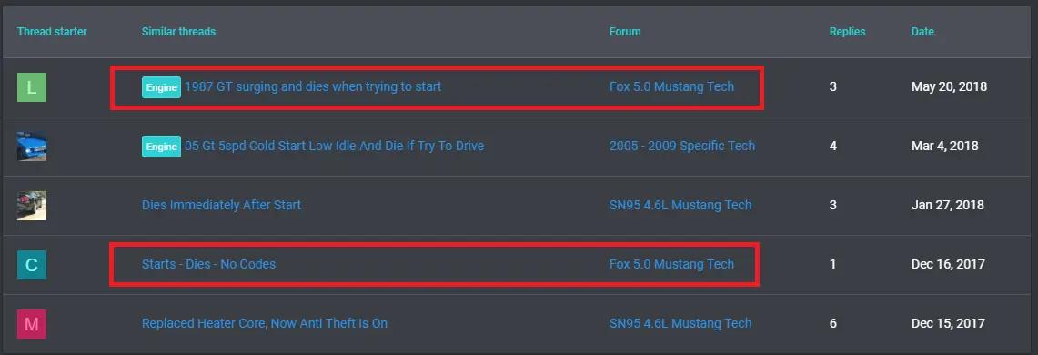

Tip #1: Meaningful Thread Titles
Let's see what suggestions pop up below if we use one.
I didn't like this feature at first but it grew on me. :) You find these down below.
