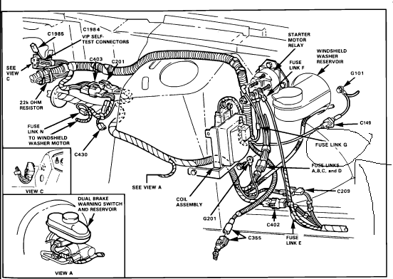

Yes I right now I can’t go further till I resolve the no 12v coil and at red green ignition wire.The switch,10 pins and the actuator rod are on their way and they’ll be at my house today. In the mean Time I did look through my fuse links I found 6 I believe 5 by the solonid and the one at the alternator, but is there one right in the corner by the ecc test connected?
Some other person mentioned that in a thread somewhere that there was a fuse link in the corner driver side,but I was looking at this pic online and I’m thinking’s he was confused. I believe he was looking at the ohm resistor.Is that a fuse link. I’m using this pic as reference.

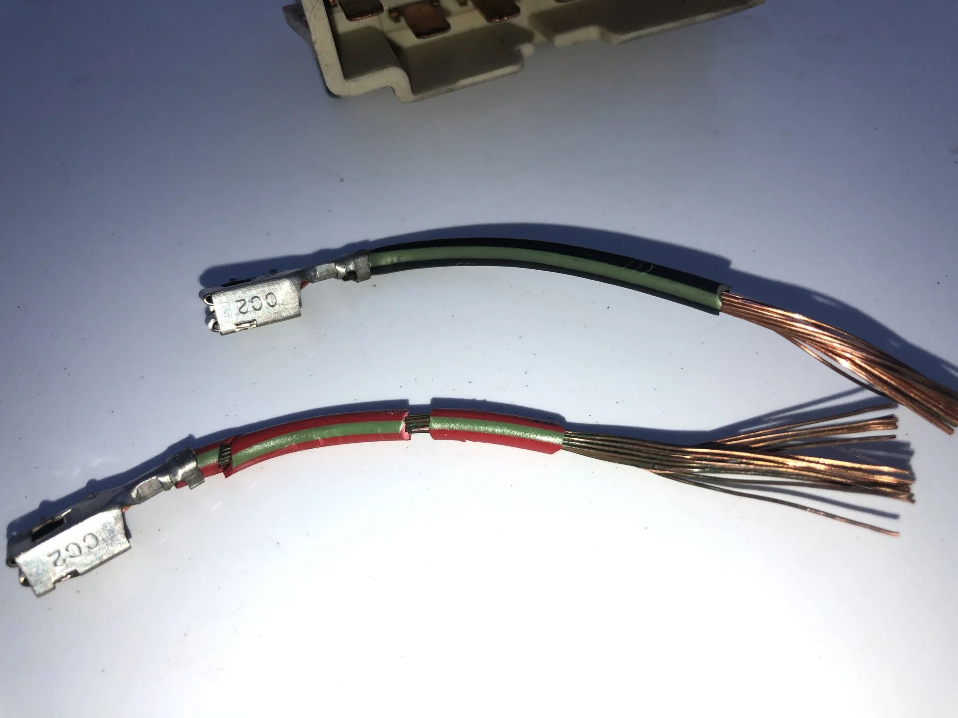

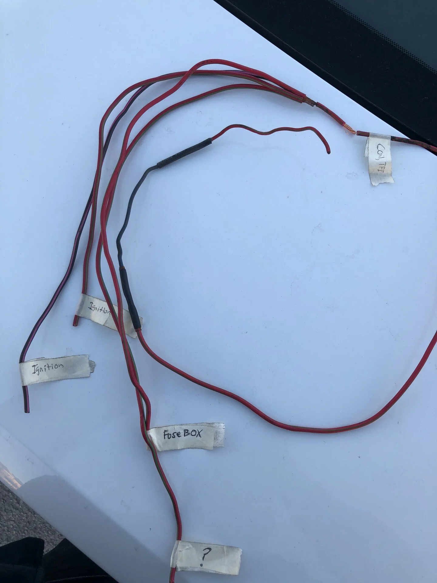

Ok I changed the ignition switch with wires but I found “Green” inside the green and red wire.I also found some on the green/bk wire. Also I could’ve sworn I had 11.58 and it jumped to 11.65 when I installed new connector and switch. I’m not getting 12 think this could be the issue?I went to junk yard pulled the whole run off another car,I noticed red / bk wire, pink wire and they are fused together with 2 other red/green wires. One went to the fuse box the other not sure where it went it was already cut. I was. Hopeing I could just throw this one in but not sure if anything else is going off the end with the “?”They aren’t in the ignition diagram. It shows the fuse link and the pink wire where they meet but doesn’t show what I have. It was out a 5.0 convertible. Not sure what year it was.I haven’t pulled out the ecc to visually inspect, and to be honest I prefer to pull it and open it then test it by jumping it(cuz I don’t know what I’m doing :) ) All in pink on my list I’ve checked. I didn’t mean to jump around but I wasn’t getting fuel pressure 2 weeks ago found out it was the fuel regulator so that’s why I went through the no fuel pressure area any input would be appreciated!
