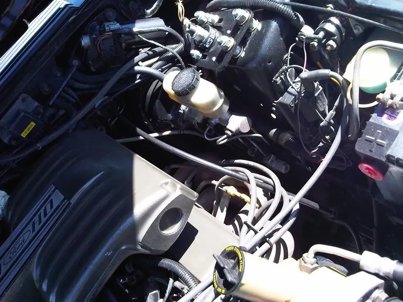

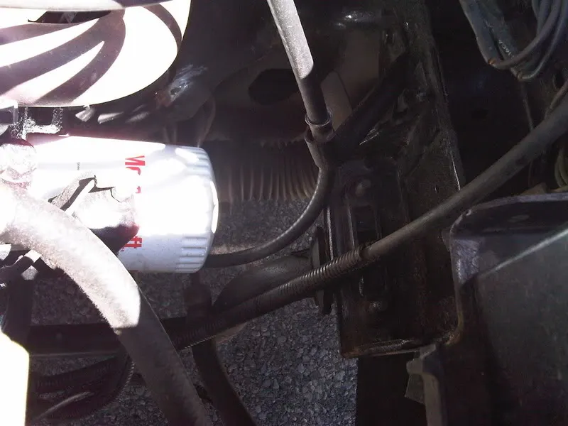

My flowtechs stick way out so I routed them up and over the headers, and down around where the oil filter is. I could have it even further away, but its also keeping my spark plug wires away from the headers lol. I think I flipped the mounting bracket over too.
Hopefully you can see what I mean in these:
