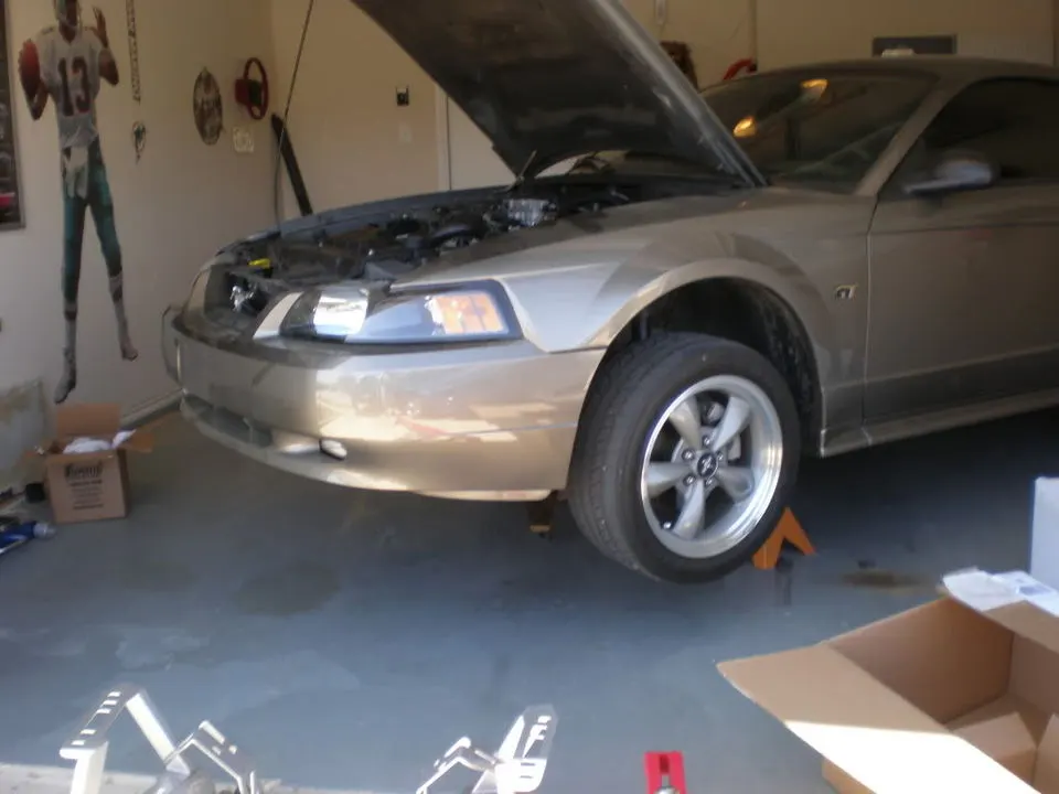

Here are some pics from the Steeda long tubes and k member install. Install went pretty smooth. The top two bolts on the passanger side were a bitch. I had a TON of help from 03whiteGT on modularrevolution. Anywho here are the pics
Here are the pics from saturday

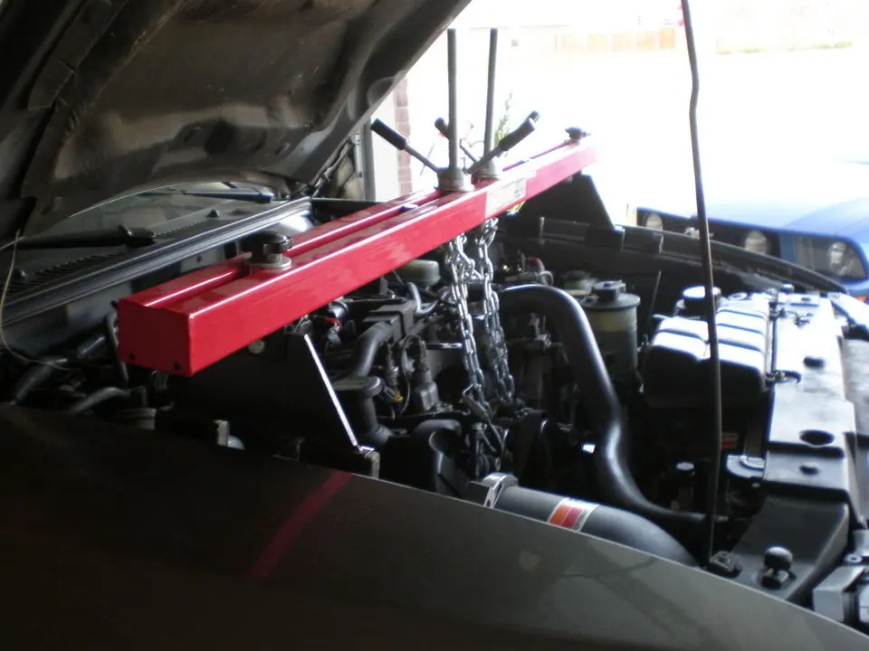

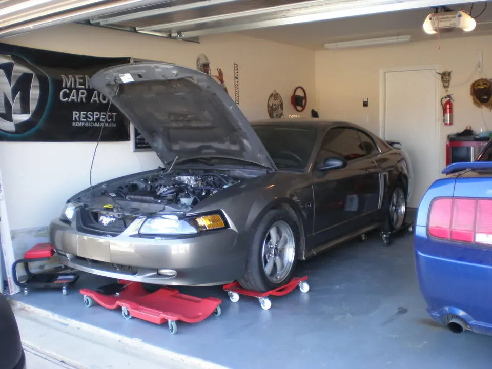

Car up in the air ready

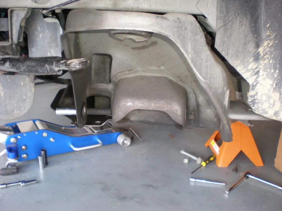

A-arm dropped

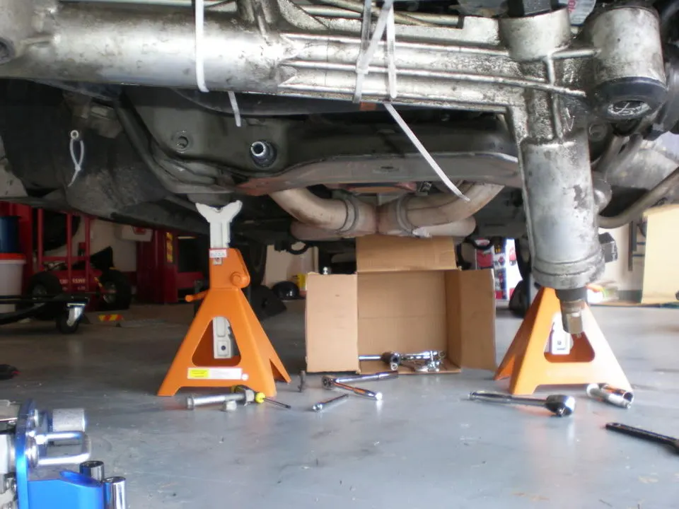

Rack jip tied out of the way
Motor braced

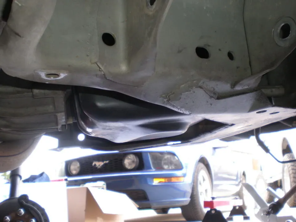

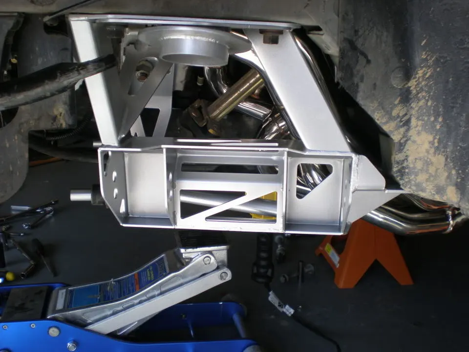

K member dropped

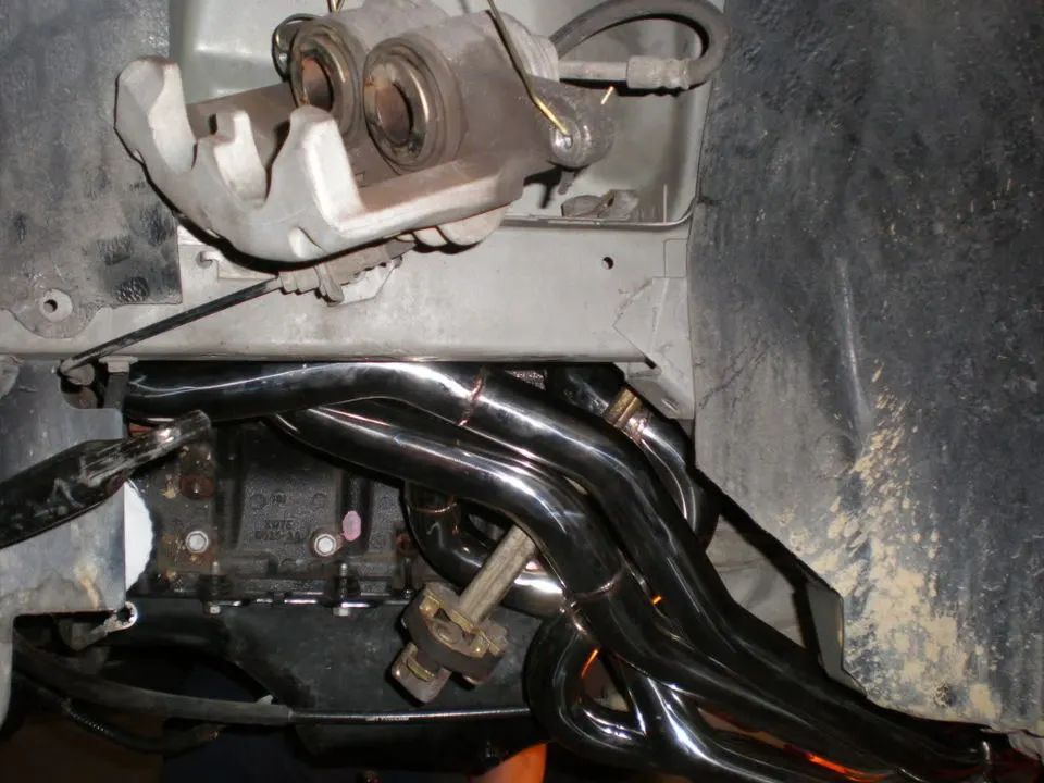

Driver side header

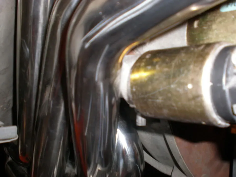

Passanger side header

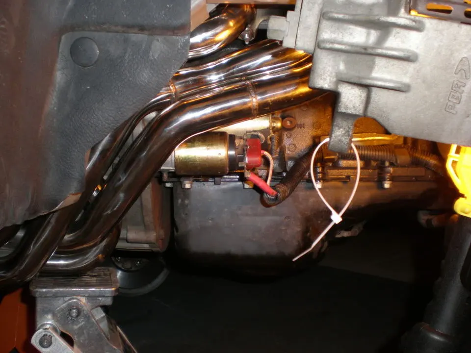

Its touching the back of the starter.

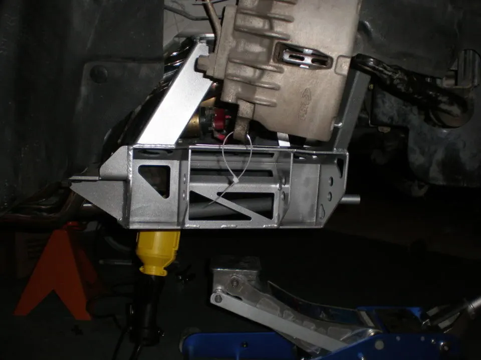

K Member on
got to button up the front end tomorrow and put the mid pipe on.

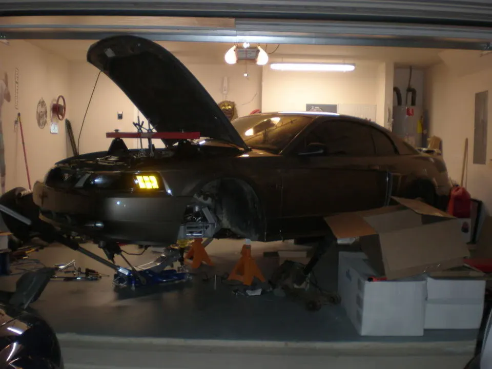

Pics from sunday.
Yeah, thats how it was last night. We finished it up 99% today. All I need is a bolt to plug the EGR hole and one stud for the H-pipe. Then its ready to run.

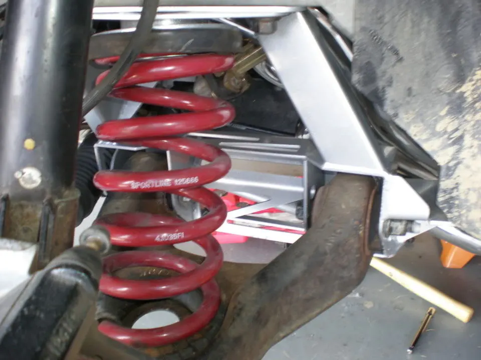

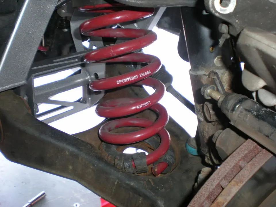

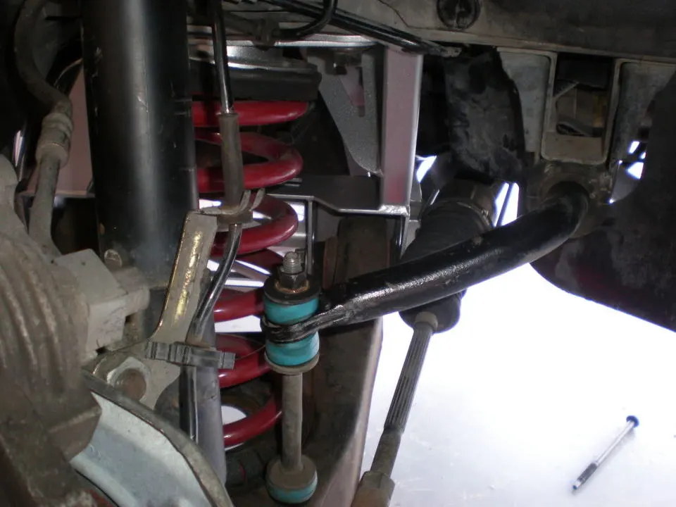

Springs in
All buttoned up
Back on the ground.

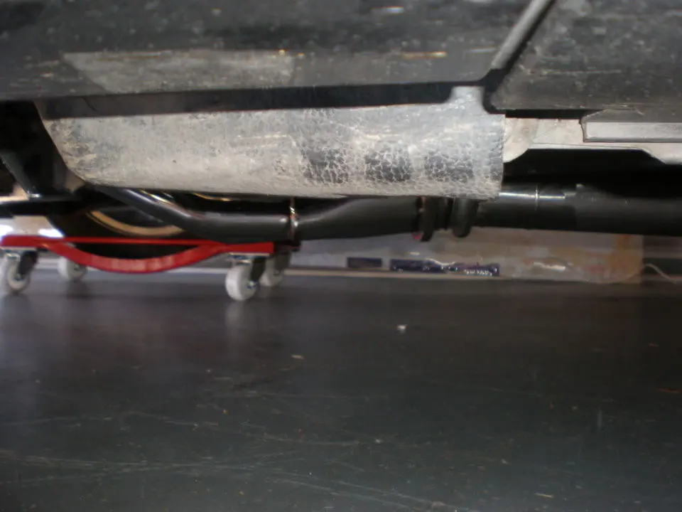

Ground clearance
Car shouldn't be that dirty on the underside but I think my dad drove it when it was in VA. I am glad he did because it didn't sit the entire time. Headers fit good and the H-pipe is only off a fuzz. Guy that was helping me said he BBK was the same so that made me feel good. Only problem I can see the o2 bungs are pointing down. Easy fix.
K member fit fantastic. It saves some weight over stock and is overall pretty cool. I don't think it will impress anyone but I liked it. I would say start to finish with breaks, trips to pick stuff up and food its a 10 hour job. That includes swapping my stuff from the stock K member to the steeda.

i just realized you had the stock a arms bolted back in...why not go with tubular? im not knocking you im just curious...i might possibly have to do that for a while with my build anyway...did they just bolt directly to the k?
I feel more comfortable with them. My car is a street car. I don't look for every 10th. I found a K member that would use stock arms.
