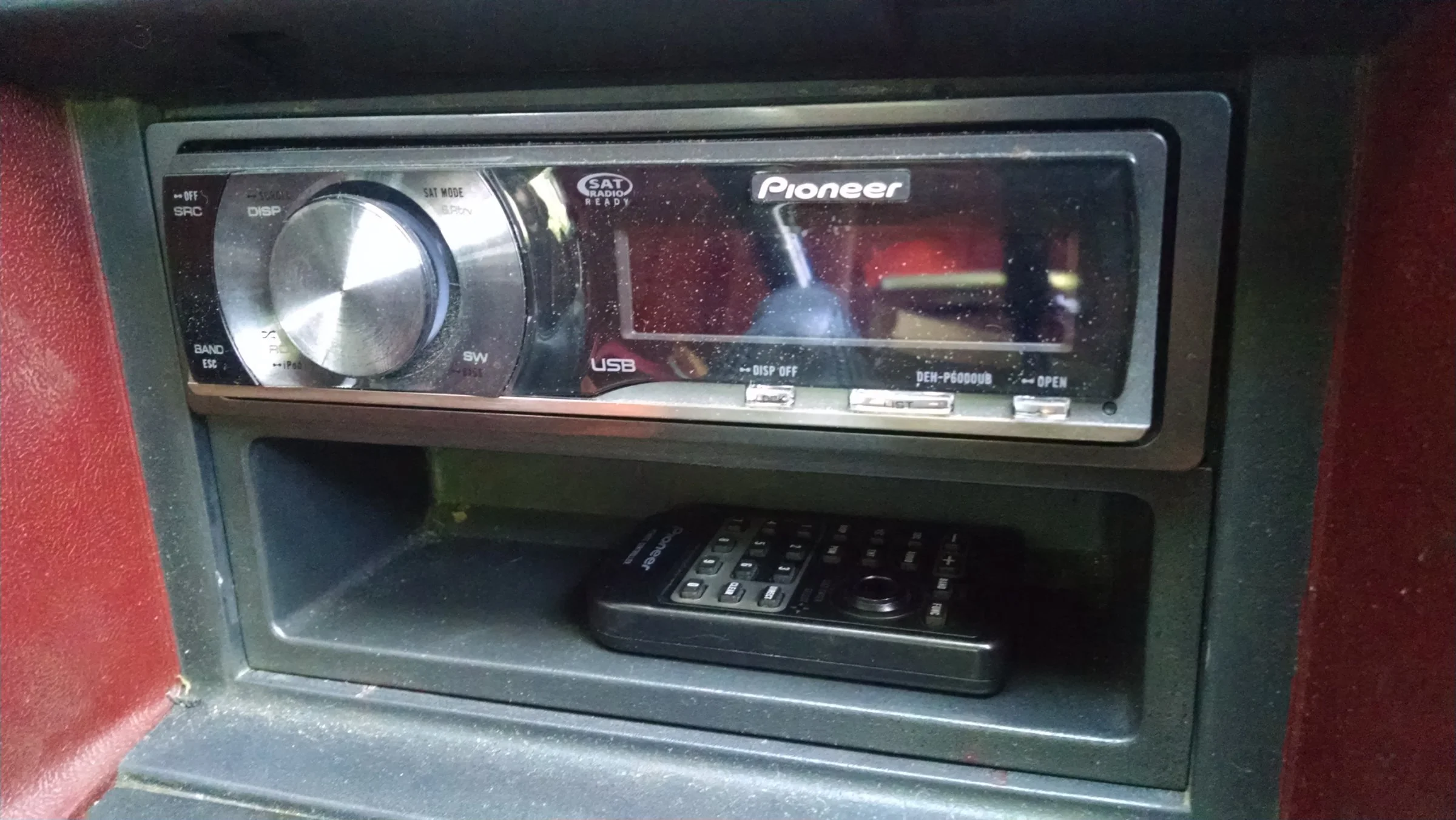

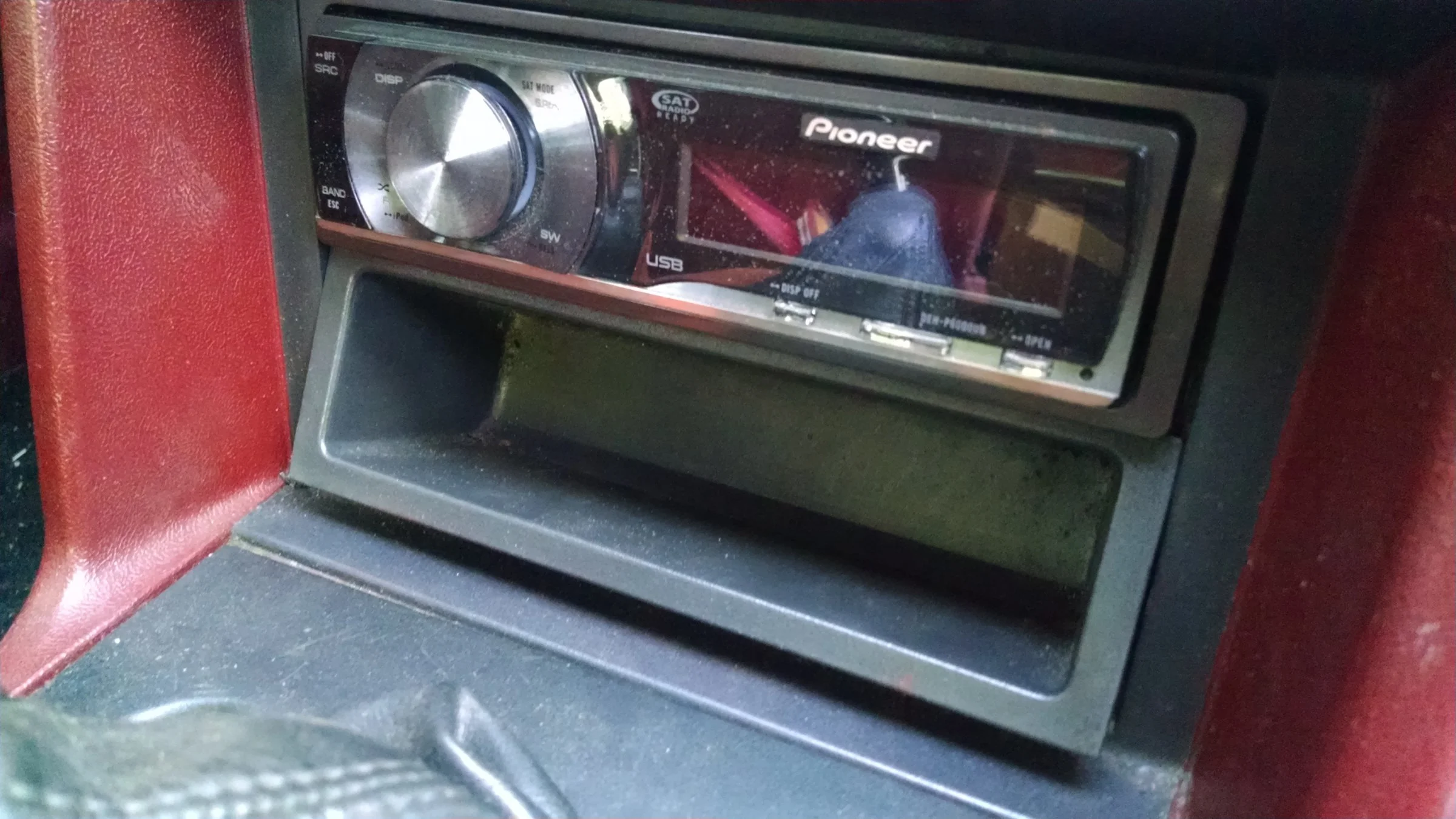

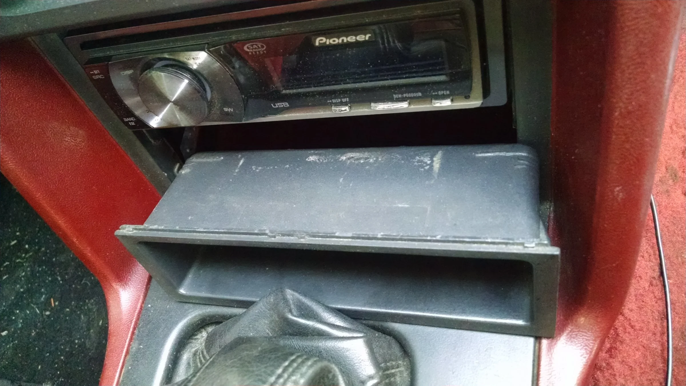

What I do is slide the aftermarket unit and outter shell into the hole and slide it up. The front of the cubby doesn't get modified at all. It goes in kinda at an angle pointing down into the slot...the top edge will go in behind the aftermarket metal sleeve... Then push the bottom of the cubby in place.
I'll post picks when I get home....about 630pm

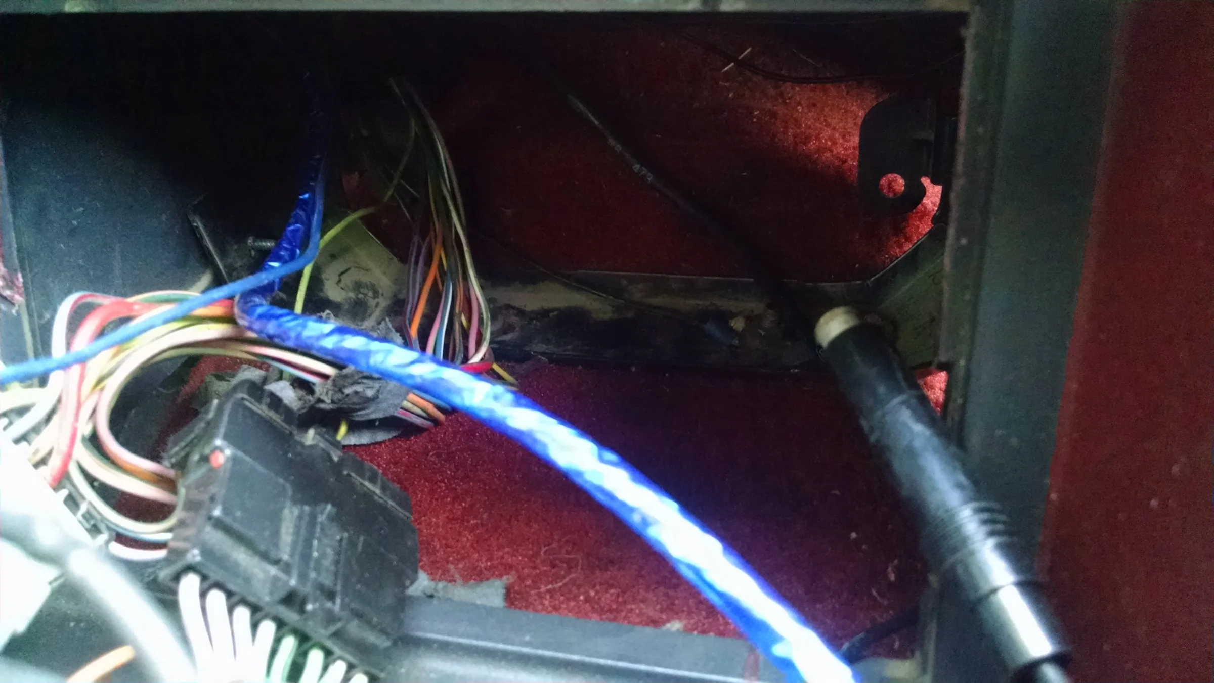

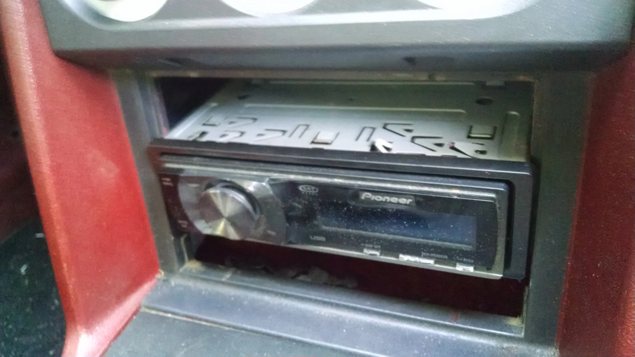

None of the factory brackets are used. The only metal tabs that i bent out were a couple on the top of the radio sleeve. It all fits together tight enough to not vibrate out...even pulling it out takes some wiggling.
