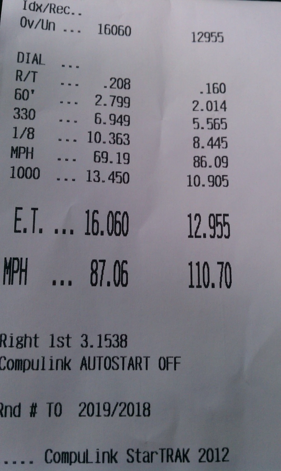

You "slowered" your car? J&Ms are good but if lowered you need control arm relocation brackets to take advantage of them. Without the brackets, the geometry is no good for launch. Being lowered makes it harder for the car to transfer weight to the rear axle at takeoff. If you're looking for fast E.T.'s, I'd put the stock suspension back on and even remove front sway bar and strut tower brace for track days. This allows front of car to "lift", and put more weight on rear to help traction. I've tried lowering pressure in the pirellis, but didnt see an improvement in 60 foot times. My best 60 ft so far is 1.95 with no front sway bar/strut tower brace and 26psi in the pirellis. 040.webp Heres an average timeslip for me. Sway bar was on this run with 26psi in the pirellis on a humid 90 degree day. 2.0 60ft is typical for me. I dont know how guys are getting 1.8 60's on the pirellis.Experience I guess. Runnin 12.9s all day while basically granny shifting due to the weak stock shifter assembly. Cant wait for my MGW to get here!
