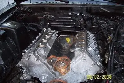

picture of my engine bay as it stands :
i do 90% of the work on my car myself: complete vortech install,k-member w/arms and coilover w/cambers, lt headers and complete exuast just never pulled the motor and kinda afraid of the tranny i am sure once i do it its not all that bad

Have the bellhousing unbolted from the motor? Have the transmission supported from below?
I just removed my 4.6 block a few days ago and its really not a hard thing to do especially since you have it so far.
I just had my 03 cobra out i wanted to try but i did mine in driveway. I think the trans would be the problem the engine would need to be on a 45deg angle to come up.i found if you remove both heater hose completely unbolt eng mounts.lift eng from front as much as u can.remove eng mounts and oil filter,brake booster if needed should than be your first 20 min header job
will wish me luck going to try and pull the motor in the morning hehe in my driveway more like in the street in from of my house
