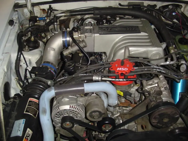

My present ride when I bought it had an aftermarket K&N cone filter, installed just direct strapped to the mass air.
I went on ebay and picked up the stock air box. Threw it in with a fresh new paper fram filter. Butt dyno picked up like 15HP.
Thoughts?
Cause when they say "Cold air" it is not accomplished by putting an open air filter under the hood that sucks in under hood hot air. Your in fender air inlet on the stock box is an actual "Cold air" intake. I had a K&N in my stock box for years. Then when I was upgrading the intake system I went with the open cone filter that sits in the fender and has a plate to keep under hood hot air away from it. Mine also has no metal plate in the front section of the cone. Its filter media all around the cone area and where the metal cap would be as well. I cant find the exact set up I bought a few years back but this should give you an idea of what im talking about:
http://www.ebay.com/itm/89-93-MUSTANG-MAC-FENDER-WELL-COLD-AIR-KIT-3693-/370401020816#vi-content
Yup that's what i was thinking.
Seems like half of the "CAI" upgrades that get done involve taking HOT engine compartment air and putting it through a K&N cone filter.
I'm really happy with the look, sound and feel of this "upgrade". Stock engineering is the way to go with stuff like this.
