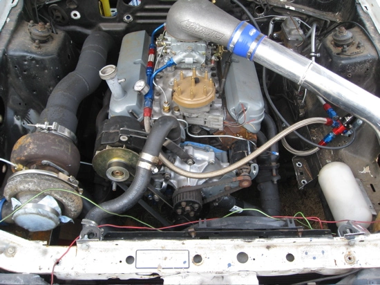

heres a pic of my junk:
not the best exhaust view but you get an idea.
we had an old h-pipe that I cut up (freebie) to steal the ball/flange sockets from, a bunch of cut up pieces, and one 2.5" u-bend to make it all work from the headers to the turbo
