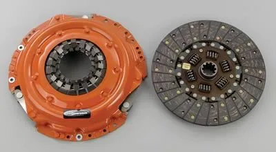

Alright so the time has come to replace the worn clutch in my T5. I will not be going with a Spec stage 4, I want something that will hit hard but wont blow the T5 up on the first few powershifts. What should I be looking for? I have only had 2 clutches in this car, and both were used and free (FMS HD ones). Toss your suggestions here...
I've always like the centerforce, easy on the leg and won't break your trans.
If i'm not mistaken, the king cobra kit actually uses a centerforce pressure plate. (this is old info i had, it may not be true, so check into it).
I always heard the Centerforce II clutch was good.. More RPM the harder it holds. May blow up the stock tranny but i don't know. I have a friend who has one in his bone stock car, he doesn't beat on it like you do but he does get on it. Hasn't blown up yet :shrug:
