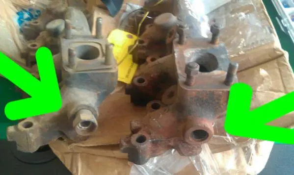

I have bought and repaired after market headers as they do not hold up. I was advised that the stock exhaust turbo manifolds hold up better. I have two now and now need some help with parts for the bypass valve. I a have attached a photo of the manifold and the area I am referring to is pointed out... Any help or pictures of how one looks put together would be helpful as well. Thank you...

You obviously haven't tried the 40Bob headers. They are a log style like stock, known to be extremely durable, far more so than stock manifolds. That fitting is the EGR adapter. Not 100% sure what you are asking. I would soak that fitting in PB Blaster to see if you can't get it loose, then just swap it to the manifold you are keeping.
Those are also both E3 manifolds that are well-known for cracking in addition to not flowing that well. If you're talking about putting a wastegate on one of those stock manifolds, I wouldn't bother. You'll have better boost ontrol even with an internal wastegate than one hanging off of a skinny hole on the back of the manifold.

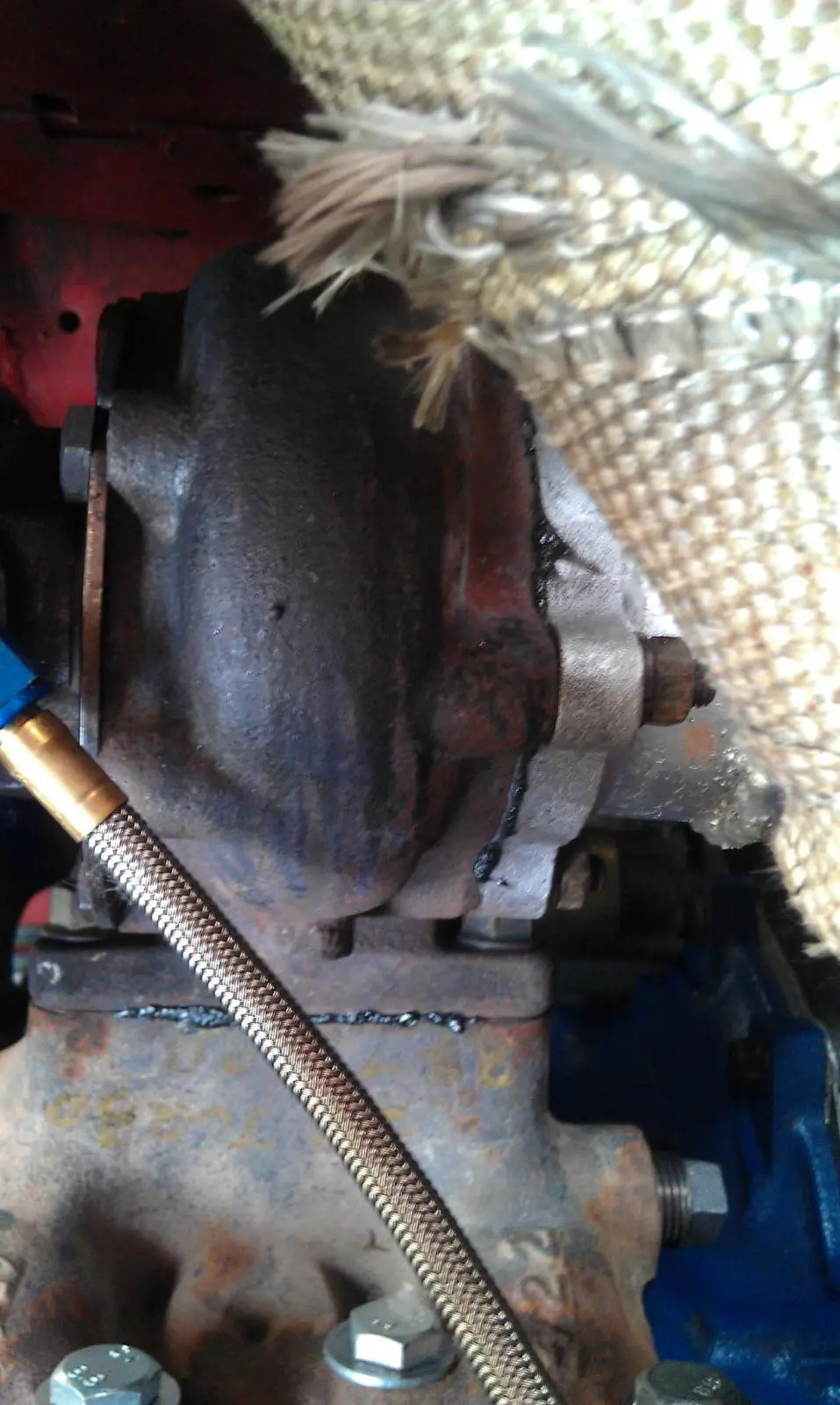

It depends on what kind of turbine your T3/T4 has. There are different "stages" of the T3 turbine available and the higher the stage, the bigger the wheel for more flow. You'll mostly likely have to remove the turbine housing and get a reasonably precise measurement of the wheel's diameters to know. It would be a good idea to do the same for the compressor wheel. There are lots of T4 compressor options. T3 turbine housings also abound on the aftermarket. The stock T3 has one that looks like this:
The wastegate flapper is integrated into a cast downpipe elbow that bolts onto the five-bolt outlet flange. Another option is to use a flat outlet flange and attach an external wastegate to that.

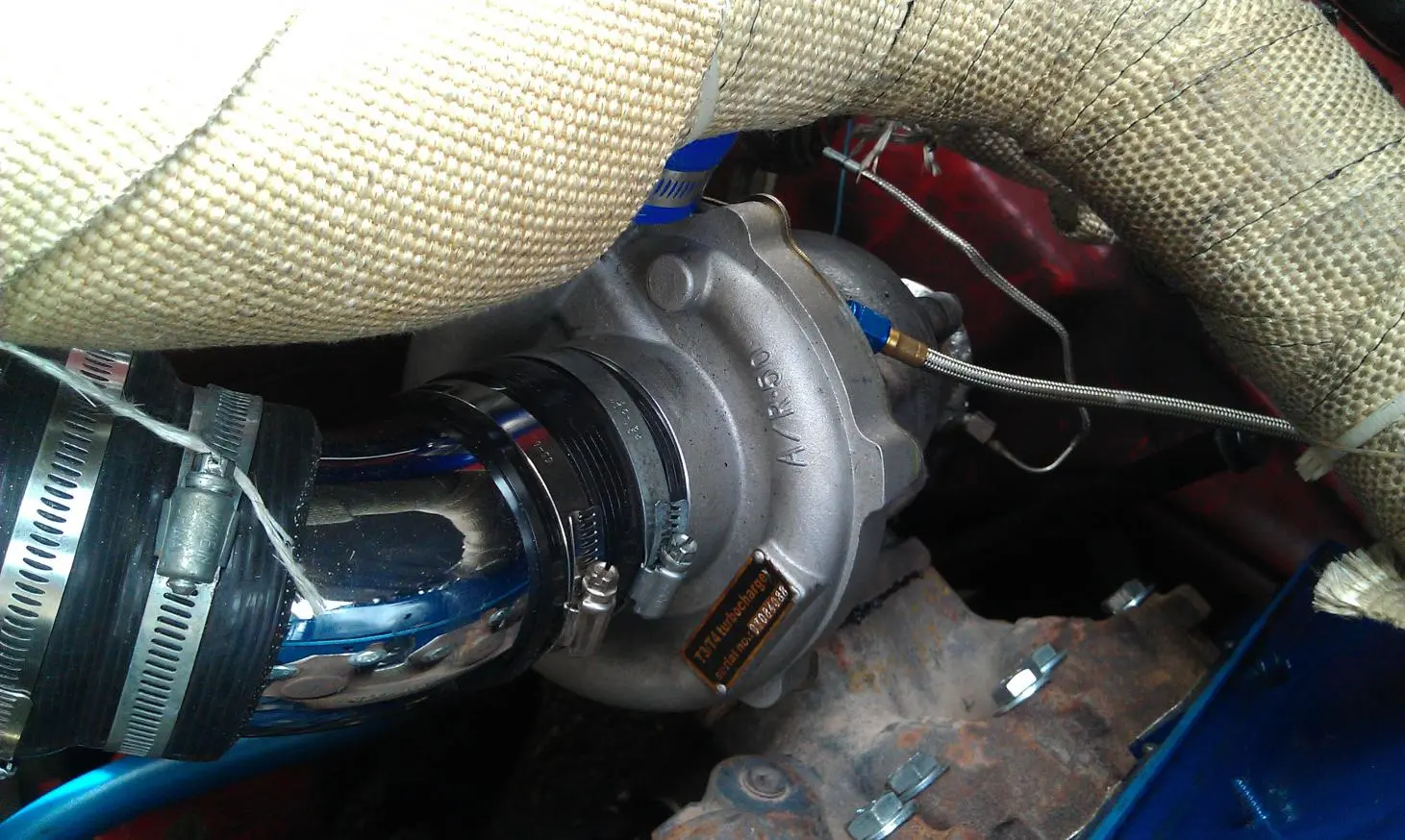

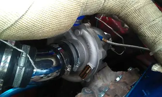

A couple clear photos of your turbo would be helpful.
