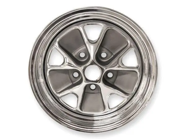

Well thanks for the advice the only thing not original on the car is the ugly paint originally it was Wimbledon white. What size tires and rims would give it more of an aggressive stance I would like larger and wider but there are so many options and miss information out there

You definitely want to back to Wimbledon. As for wheels and tires, get an early Styled Steel wheel. Not really correct, but you'll get less flak than with aftermarket wheels.
Here's a wheel and tire chart-
Mustang Wheel and Tyre Chart
