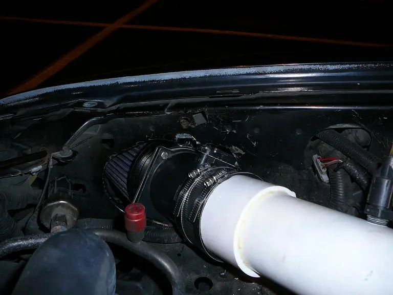

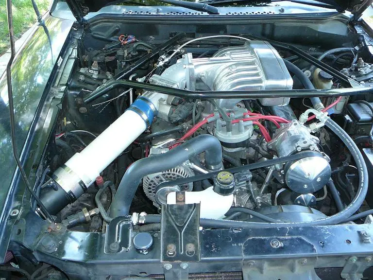

Straightened out my intake tubing

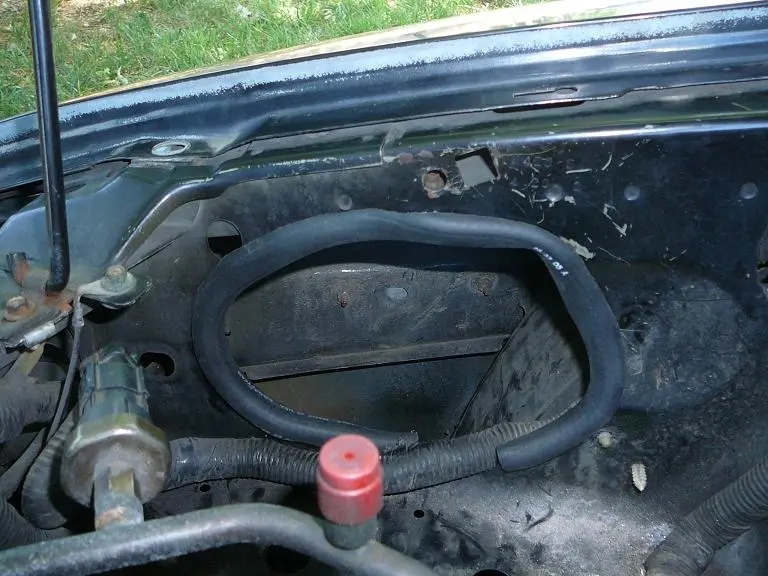

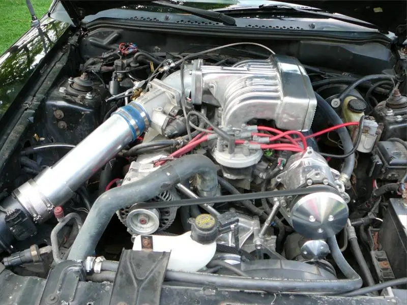

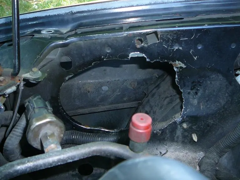

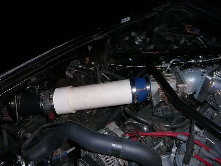

it is not completely finished yet ... i still need to paint the PVC, smooth out the opening i cut in the fenderwell, line the opening with hose, and turn things around so it looks cleaner, but here is where it is right now. btw, this took about 1/2 hour.
i need to get a black connector, the blue sticks out too much. should i paint black or silver?
fwiw, a 3" PVC with a joint fits the 90MM LMAF perfectly

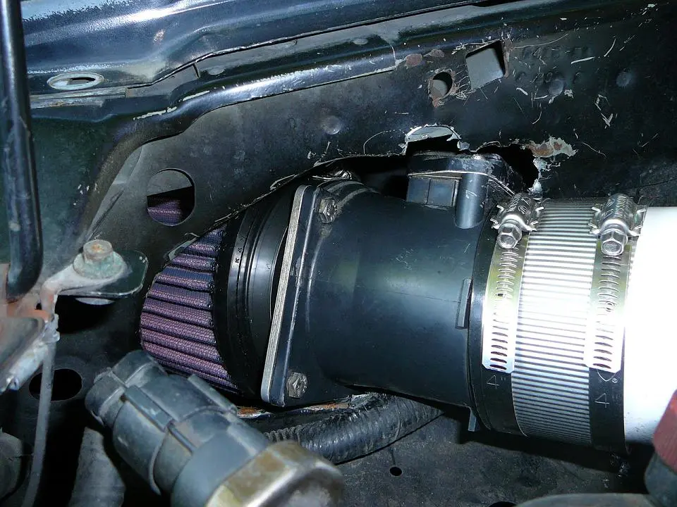

in the fenderwell, 4" K&N, about 5 3/4" long

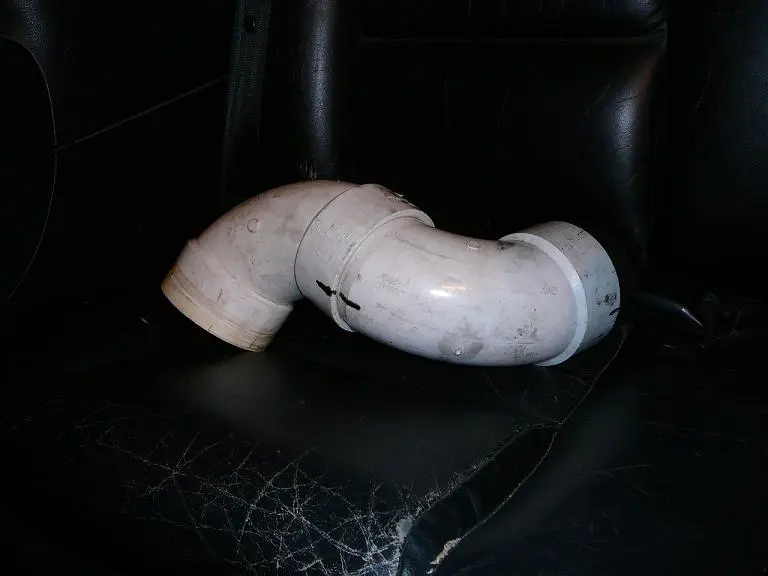

here is what was in there before. the filter fit great, but it made for some hard tuning because the air flow through the bends really affected the MAF readings
I like... Much better than all the bends. That was one of the reasons I did mine in the same fashion. Keep us posted on the tuning part of this mod as I would be interested in seeing what happens.

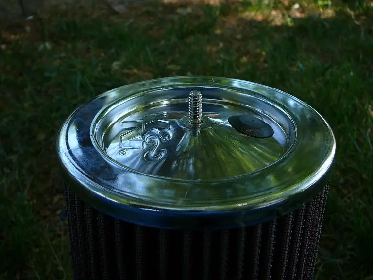

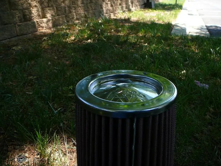

the K&N ... it has a stupid bolt and a hole in the cover
without the bolt ... i found a plug for the hole
the hole

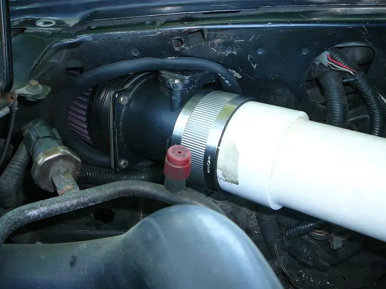

with liner ... a fuel line i slit lengthwise
it's a tight fit
back together
so far, so good ... now i need to paint the PVC and get a black connector so i can get rid of the stupid looking blue one.
