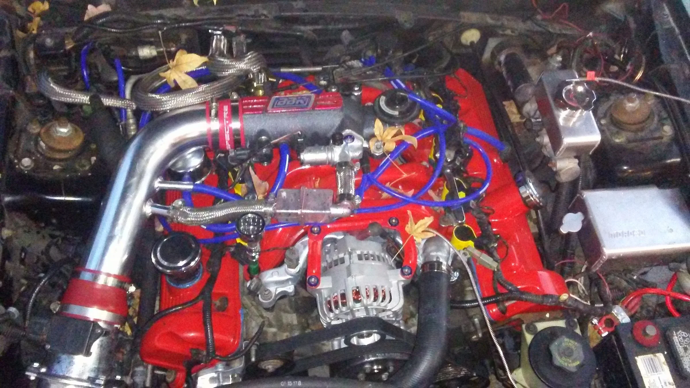

Lets go over that is wrong:
Too big of a fuel pump, find a stock one.
no reason to run 42lb injectors unless you are boosted or have Nitrous. Put the 19lb/stock ones back in
the vacuum lines appear to be connected wrong in that picture...too much of a mess to figure out.
The cam covers/valve covers are from two different generation of engines. Passenger side appears to be for a Romeo engine and the driver is for a Windsor or a Bullitt Mustang.
For the tune, unless the car has cams, then putting it all back to stock wont hurt anything. Even if it had ported heads, running with the stock injectors and pump wont hurt it. You'll just be down on power until you can get a real tune. So, put the stock parts back in it and try to find a diagram or a stock engine bay to fix that vacuum line mess. Then worry about tuning it.
The only time you'll need to worry about fixing the tune is if it has cams or ported heads. The car probably just has gears and exhaust.
