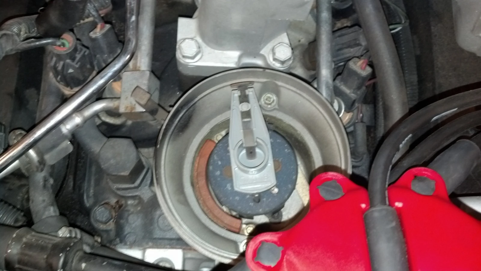

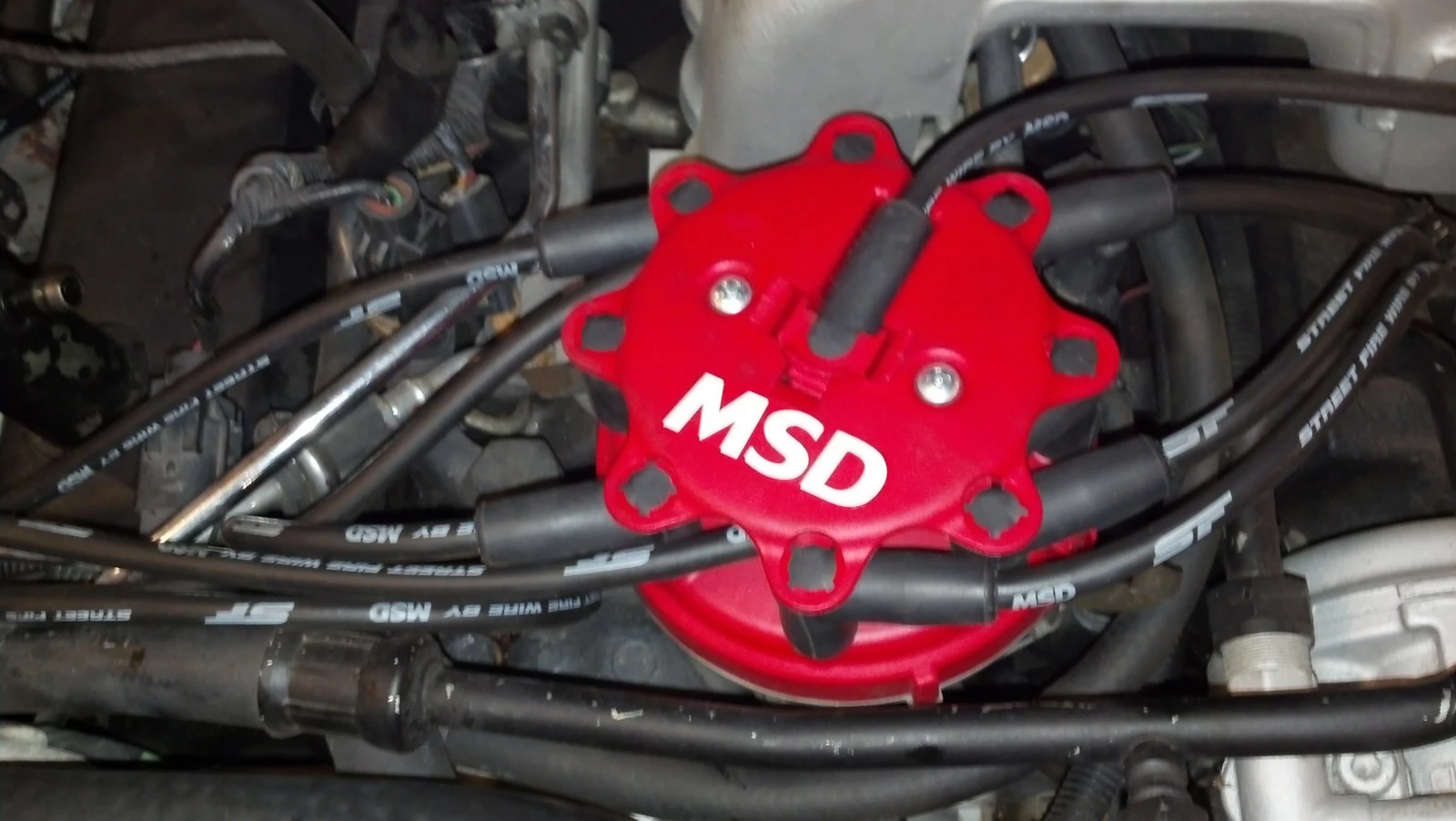

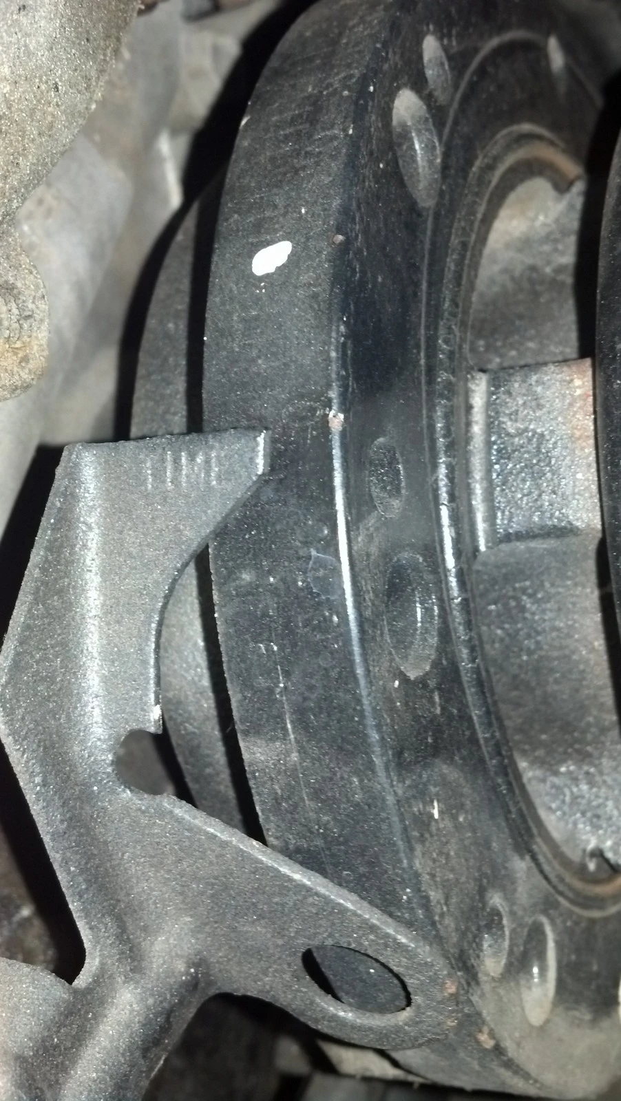

Ok, after thinking the balancer had spun, I proceeded to verify the timing. The method I chose was to take the passenger side valve cover off, turn the crank bolt clockwise until I first saw the #1 exhaust valve open, then close, then the intake open then close, then marked my position and turned the crank 180 degrees. I then stuck a pencil in the #1 spark plug hole and turned the crank more, then back counter clockwise and a few more tweaks until I could feel (through the pencil) the piston was at the top of it's travel. Only then did I look at the balancer and it was right on 0 degrees. I then took the distributor cap off and the rotor was pointing slightly before #1.

Here are pictures of how everything was when I verified TDC.
Based on the pic of my harmonic balancer pointing at 0 and TDC verified, should the rotor be pointing (left) of #1? In the picture, #1 is the closest to the intake or closest to 12 o'clock position. I thought the firing rotation was CCW therefor the #1 would have already fired.
Some more insight would be good. Anyone have any thoughts on this?
