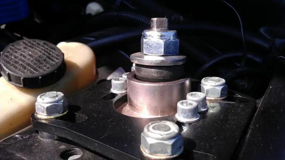

Two things at play here. I went through the same problem until 1st-I had bushings machined to comp for the undersized shaft(had a machine shop bore and size 2 oil-lit bushings, no problems). 2nd-the strange struts "click" when actuated on a hard surface (like there is a hair of play) that I found would resonate through the whole car. I used poly bushings and bellville washers on top and custom machined aluminum "cup" retainers with the same poly bushing on the bottom side of the cc plate. I have no noise what-so-ever. Hope this helps!
