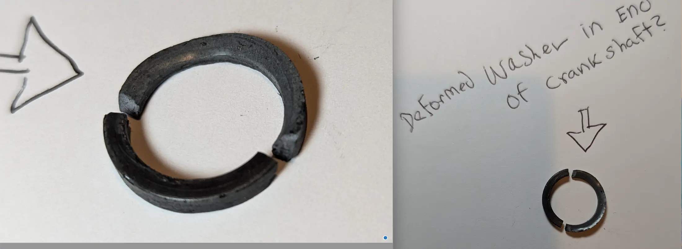

- There is a broken ring at the end of the cranks shaft hole (I think its called a crankshaft damper ring???) - please correct me. I need to know the name so I can get a replacement for it (see attached image)
