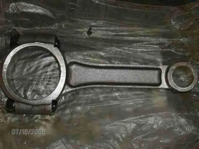

I am building a 408 as we speak.

What kind of setup you using?
