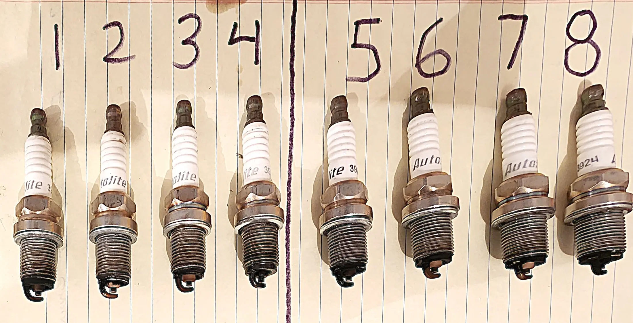

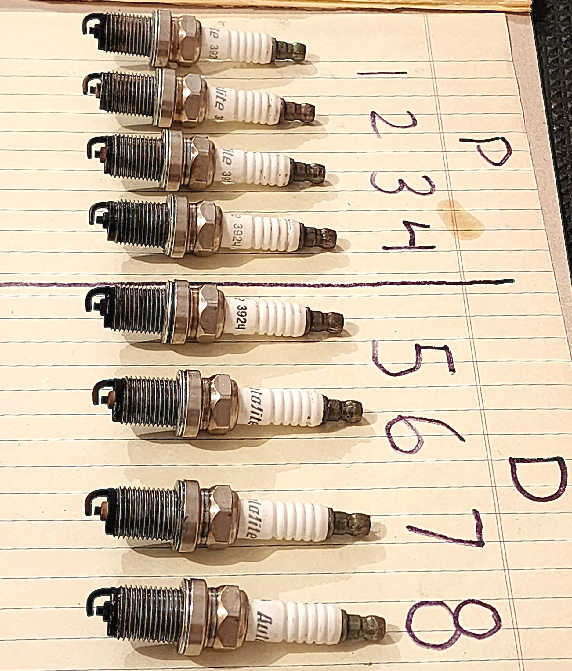

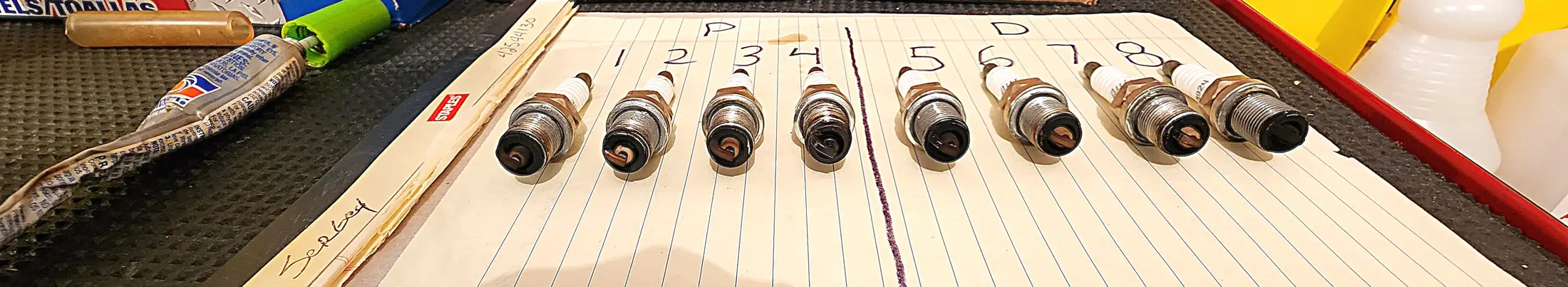

What is interesting to me is that on a carb setup the four corners are showing fat and the center four are showing lean which I find to be opposite of what most get. Runners on the corners are longer so they tend to get less fuel. This is of course as long as the ignition system is working like it should.
I was pondering the same. I don't have any suggestions here but I don't think changing spark plugs is the solution here
Definitely a distribution issue rather than spark in my opinion.
The possibility of a bad distributor cap causing a weak spark on those cylinders, :scratch:
I need to look and see what the floor of that intake looks like, is the spacer open or a 4 hole unit?

The issue lies on the 4 corners, not bank to bank.
I second the notion of the carb spacer type, open or 4 hole?
open spacer.

So has this problem been there the whole time or is it recent? If it’s recent you may want to do it again.
I have had the problem the whole time, been on the road for about 5 years. I do not have any complaints as to how it runs, it runs great.
The only complaint I have is as I said the 4 corner cylinders being richer than the inner 4 cylinders.
The plugs end up getting fouled after about 20 hrs of run time and the O2 sensors last maybe 30 hrs before they malfunction.
The oil gets Black and has a gasoline smell so I change the oil when I change the plugs.
My tuner says it runs on the rich side but that is the best he can do to keep idle and driveable.
He said if that is not good enough then I should go the way of aftermarket EFI.
Well all I can tell you is that the 351W in my Thunderbird has a CarbShop 830 on it with a Victor Jr and the corners run just a shade lighter on the plugs than the center four. I have always attributed this to the shorter path of center four runners getting a little more fuel at higher rpm. When running the nitrous the corners are pilled one step higher than the center four on the fuel side to compensate for this and the plugs look dead even.
So from my experience and my engine builder's experience (he is the one that tuned the car) the corners run lean on carbureted motors. This is why your situation is weird but intriguing.

Wonder if it is a fuel atomization issue i.e. its not getting atomized small enough so the corners cannot move the heavier particles to them like the center ones can?
It runs pig rich at idle until it gets warmed up, the carbon spots are 1/16" thick.
Check out the spark plugs.
