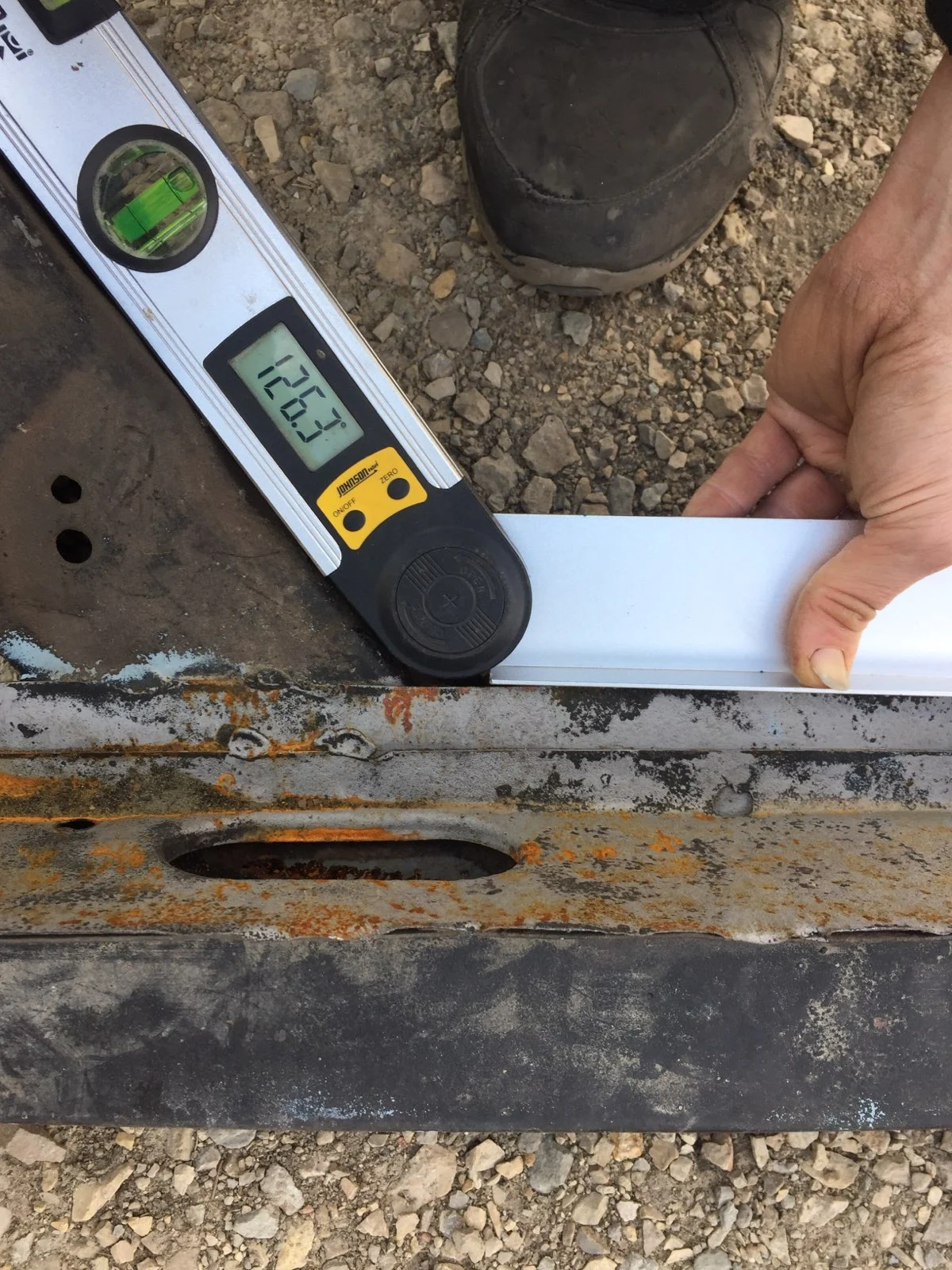

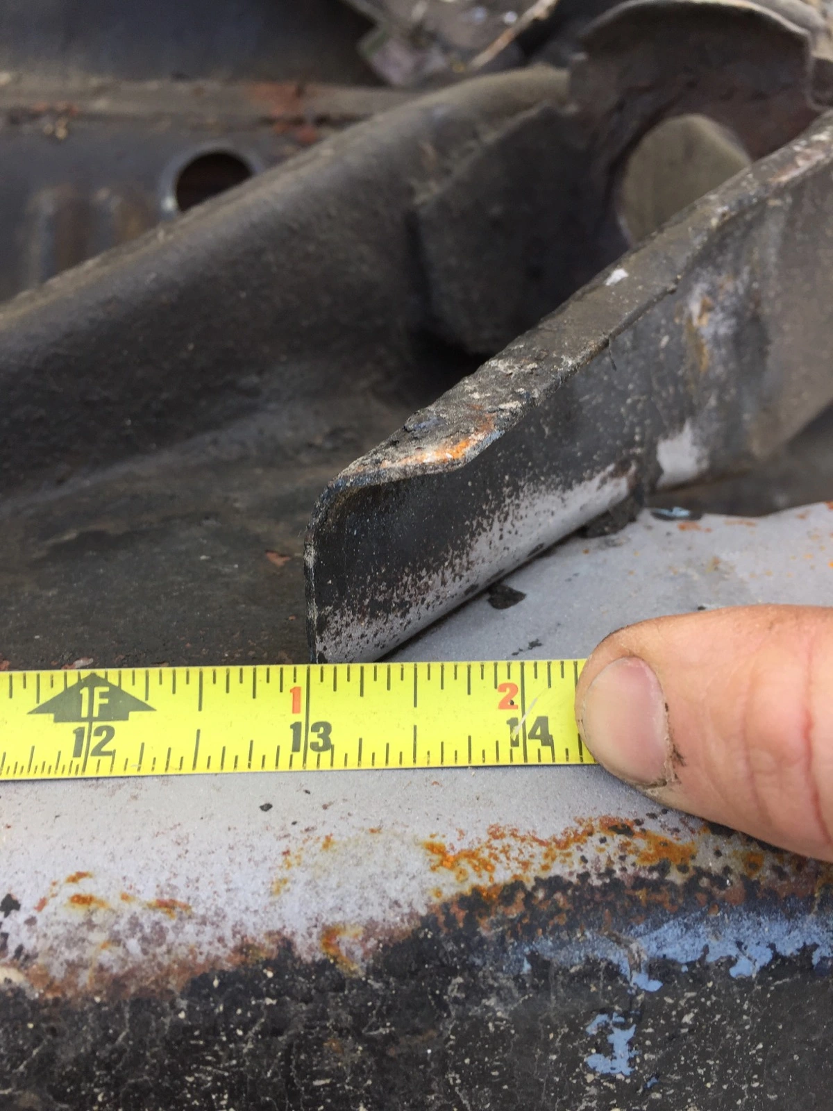

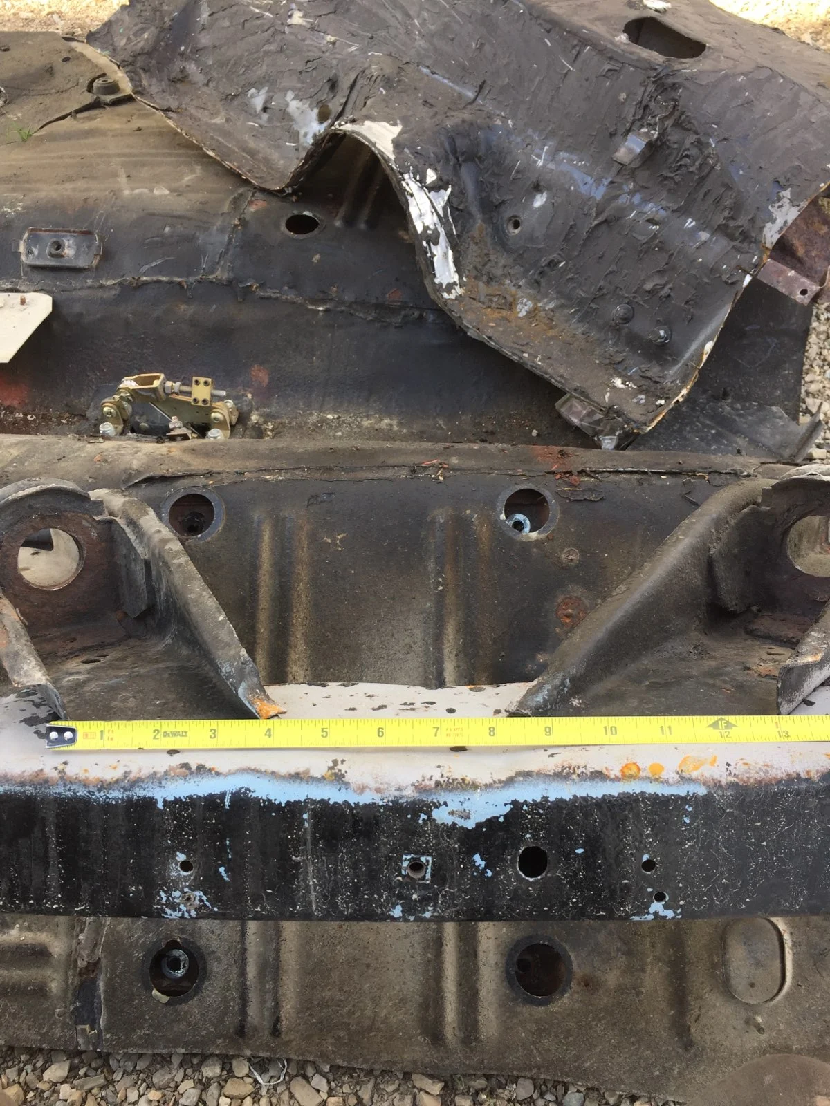

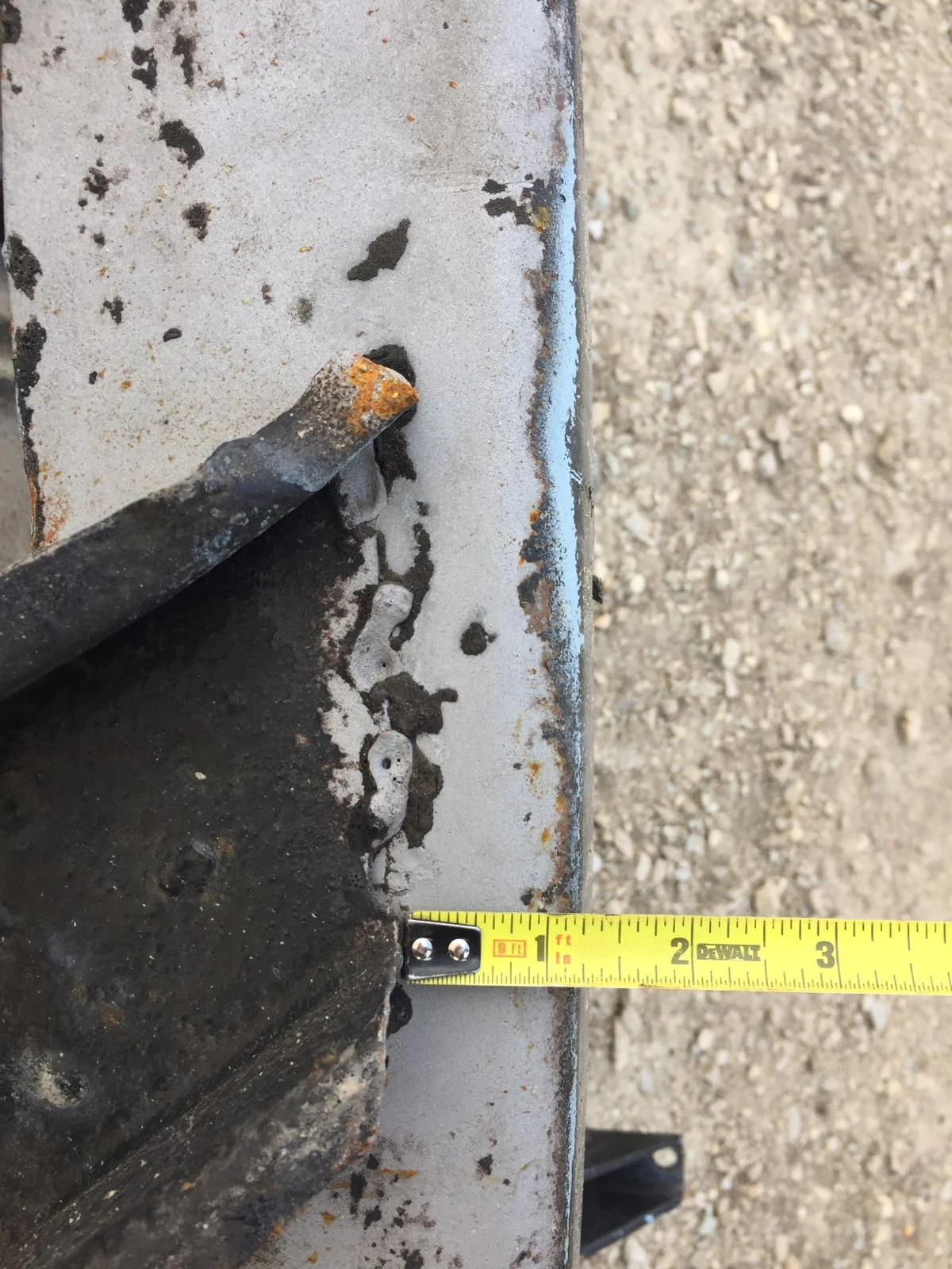

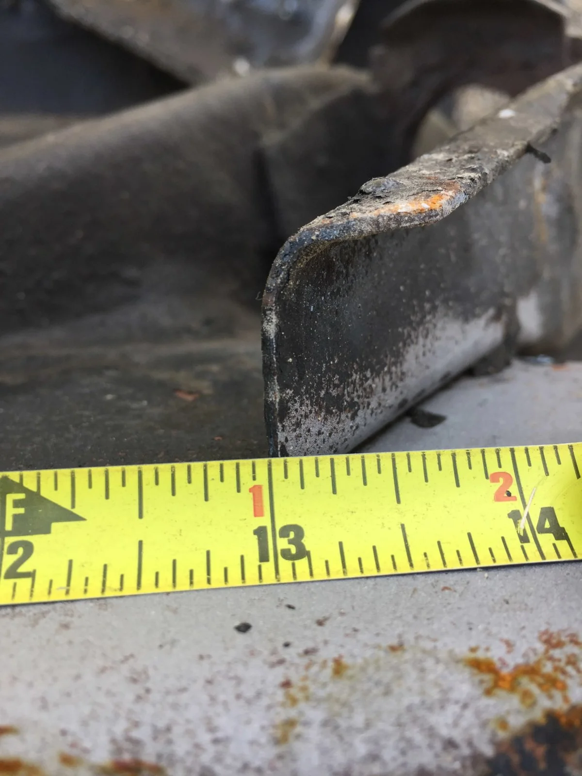

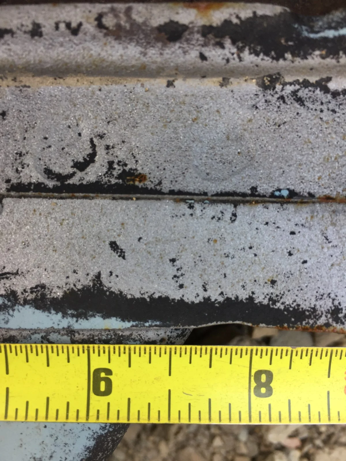

W wils1514 New Member Sep 20, 2011 10 0 1 Apr 25, 2020 #3 Apr 25, 2020 #3 I will also be replacing mine on my 67. These pictures are where the brackets connect to the cross member. To the best of my knowledge these are original and have never been messed with. Hope these help. Attachments IMG_2233.webp 423.9 KB · Views: 219 IMG_2234.webp 235 KB · Views: 197 IMG_2235.webp 318.7 KB · Views: 237 IMG_2237.webp 361.9 KB · Views: 197

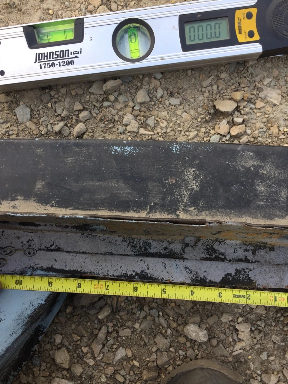

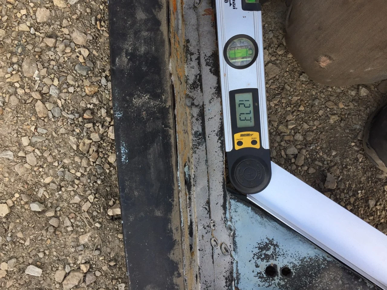

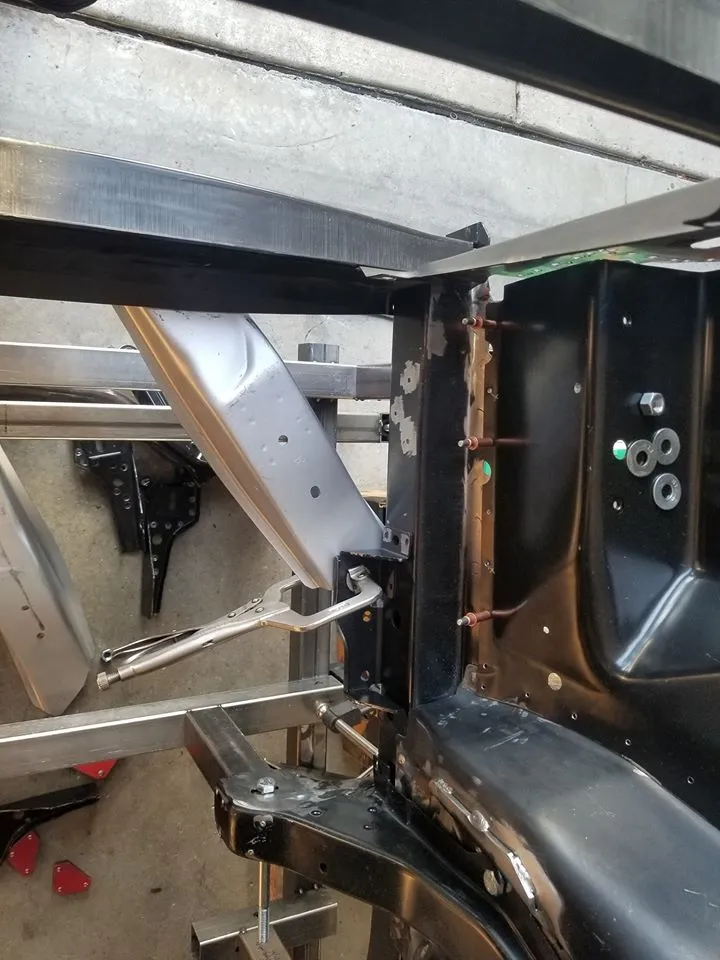

W wils1514 New Member Sep 20, 2011 10 0 1 Apr 25, 2020 #4 Apr 25, 2020 #4 A couple more... Attachments IMG_2238.webp 334.5 KB · Views: 230 IMG_2239.webp 312.1 KB · Views: 209 IMG_2240.webp 120.4 KB · Views: 214 IMG_2241.webp 285.7 KB · Views: 214
