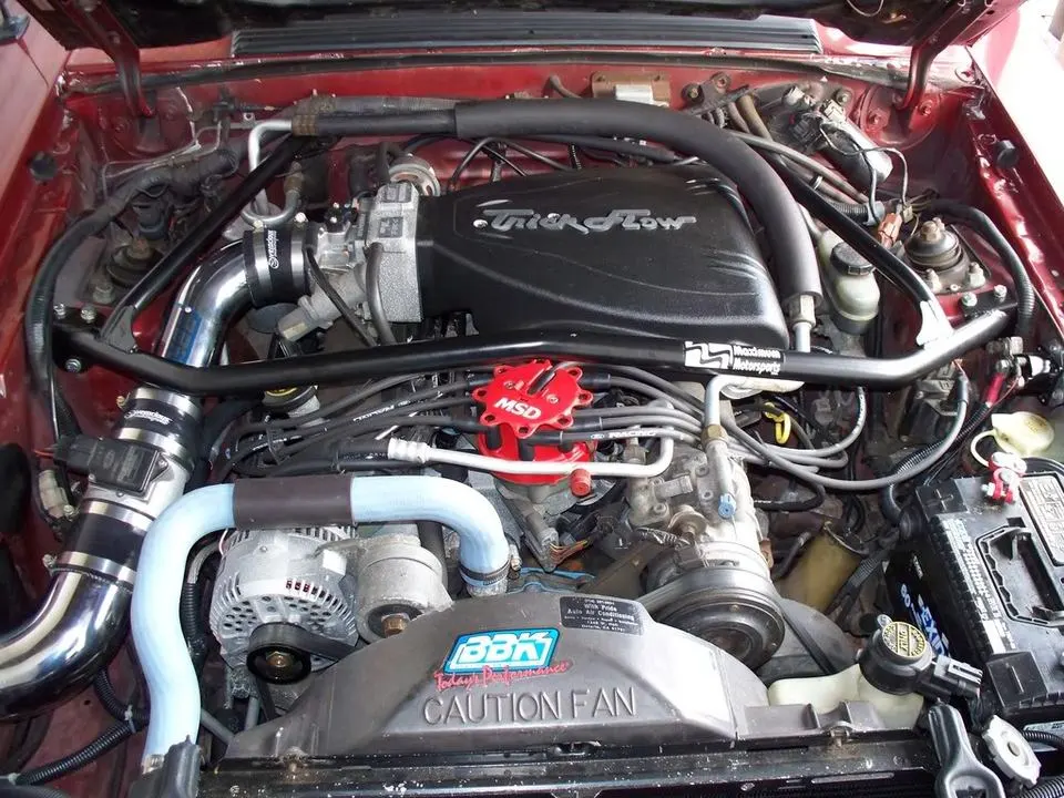

i have the trick flow track heat manifold, and the Maximum Motorsports strut tower brace clears, but i don't run a phenolic spacer

i don't think so, honestly... the main problem is dependent on what kind of CAI you're running, anything but the stock air box will not clear the brace... it's hard to see from the photo, but mine is actually contacting the brace right now, and putting it an inch higher would make it nearly impossible to put on/off
best bet is to call Maximum Motorsports and talk to a tech, because i believe the strut tower brace designed for carb instead of EFI gives you more clearance to work with, good luck
