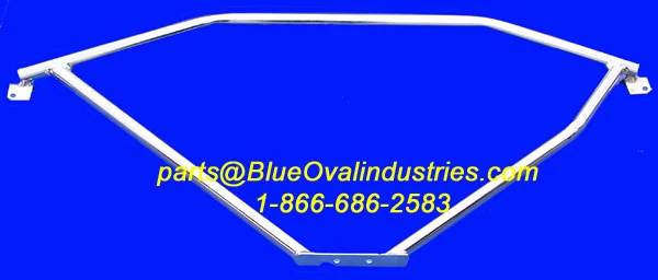

How are strut tower braces installed?
Im looking at one like this on ebay:
Im assuming it bolts on somewhere along the firewall area, but where and how?
I dont want to have to take the whole car apart to put one on.

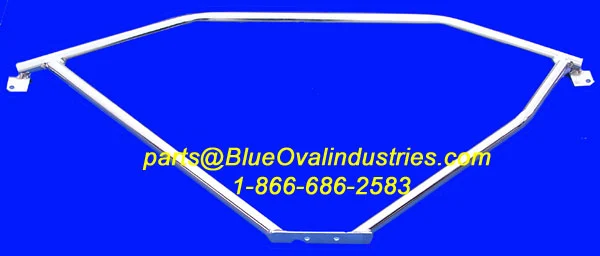

Also theres this style:
Im assuming this one bolts to the cowl area under the plastic cowl. Is that right?
Which is the better one of the two?

They bolt to the strut towers (obviously) and the firewall. I have one similar to the bottom one and yes, it bolts to the firewall under the cowl area. It is pretty easy, probably a half-hour install. The top one probably bolts to the pinch seem on the firewall. Looks like the top one might clear a wider variety of intake manifolds, but I don't know which, if either, is better.
It's my understanding, though not my experience, that long term use of the strut tower braces that bolt to the firewall near the cowl can cause cracking because the metal is so thin there.
The strut tower brace you have pictured on the top is a poorly made, cheap rip-off of a Maximum Motorsports design. The Maximum Motorsports strut tower brace will allow you to use a wider variety of intake manifolds since no part of the brace will go over the upper intake, and it is made of much stronger tubing and attaches to the pinchwelds.

Where exactly would I be drilling the mounting holes for that one?
Is it somewhere where I could get a nut and bolt in there without taking alot of the car apart?
Do you (or anybody else) have a pic of it installed?

Maximum's web site has detailed installation instructions too.
Thanks.
Does the brace make working on the engine a pain though? Changing plugs, etc?
I didnt even realize there were instructions on the site. It doesnt seem like too bad of an install.
Accessing the basic stuff shouldn’t change too much. I haven’t done anything major where the brace was in the way. I need to use a funnel when adding oil and access to the brake reservoir isn’t as easy. But, it’s no big deal.
The install was pretty easy. The biggest pain was drilling the hole and moving the vacuum tree. I needed to install a longer hose between the tree and the reservoir.
Remember that the car needs to be on flat level ground when you mark the mounting holes.
