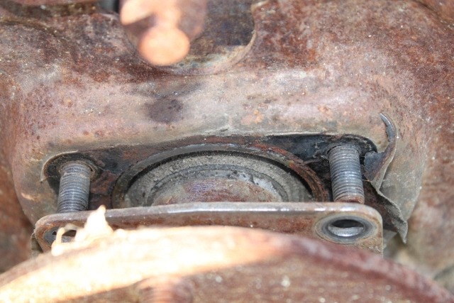

I am stuck with a problem and need a meeting of the minds. I installed the rear axle into the car and then re-installed the rear axles with the same bearings that were on to begin with. I bought the rear end loose so I'm not sure if it had any issues prior or not. Of course when removing the axles I did not take notice if this was an existing problem so I'm not sure.

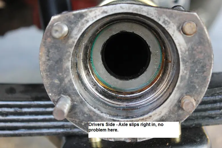

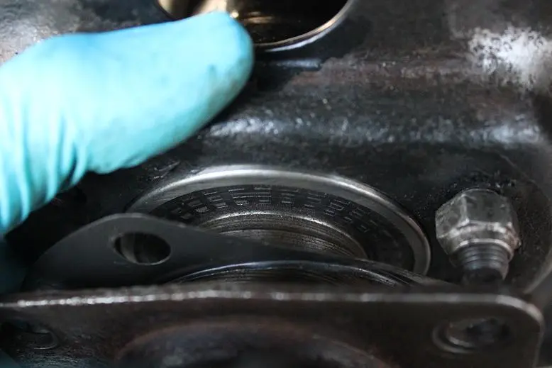

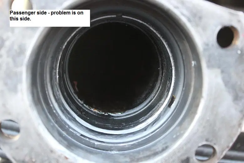

Drivers side slides right in and the axle flange to axle plate tightens up and all is good. On the passenger side though the bearing will go in only so far and then stops with it still sticking out of the race by a 1/16" or so. Cannot get it to go in further. No glaring material in the race that would stop it so I'm stumped. Anyone have any ideas as to what the problem may be????

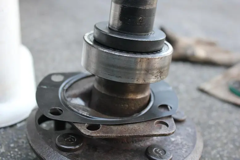

I have attached some pics where you can see the bearing sitting not all the way in. When I tighten up the axle flange to axle plate bolts the axle gets tight and if I keep going it will no longer turn.
Thoughts??

looking at you pic again it looks like the bearing is seated correct. it looks like the tin shim behind the bearing may be interfearing with the retainer plate seating correctly ,will it slip over the bearing?
Yes it does. Really weird..I actually reversed that tin shim thinking the small flange may somehow be interfering. Maybe I should heat the axle first and then try to send her home. A brain scratcher for sure.

Bearing turns nicely with the axle out. Also, as you stated the axles are in the correct side. We're talking about 1/8" or so until she's home but just won't go that last little bit. The axle are completely different in length and I think it would be very clear if they were in the wrong way.
