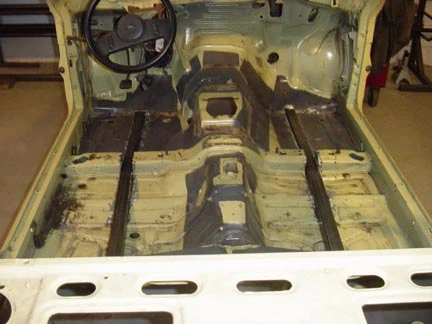

The stock body twist more than you know!! The right way to do them is through the floor from the fire wall to the rear bulk head!
Like this!
