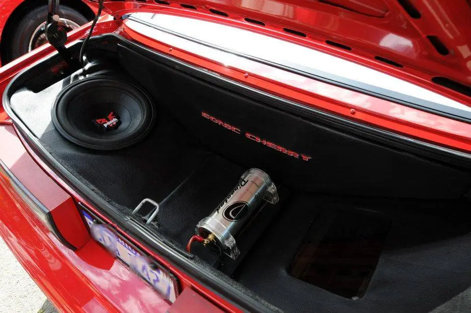

I am using 2 10's glassed into the spare tire well, they fit flush with the trunk floor. I can post pics if you want, I'm just about finished withe the install.
I did this, but as far as the BOX itself goes, it only takes up about 30% of the floor. You could make a smaller box but in the same location - out of the way - and mount the amp behind it under where the top folds down.
This is for show, of course, but I do have a little storage space behind the 'sonic cherry' panel in the back since I took out the plastic molding.

Glass'ed? Yeah, I would love to see pics. Sounds like some wild work.
Actually, all the glassing is hidden. The bottom of the enclosure is glassed to the shape of the spare tire well with a flat MDF top. I am just about finished with the wiring. I still need a headunit and my other speakers so I don't know how it sounds. I also have some fatmat sound deadening on the way.

Philstang - That is very nice. Very professional looking and you still have trunk space. I will indeed give the setup some excellent thought. Have you tried it yet? Is there a reason for the tire iron holding up the trunklid?
Thanks, I am awaiting buying a headunit and the other speakers before I know what it will sound like.
You should definitely check out Alan's thread :nice: , that is what gave me the ideas/inspiration to do this.
The tire iron is my makeshift prop. When I bought the car the mechanism that held the trunk up was not on the car. I realy don't know what should be there to support it... :shrug:
