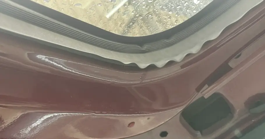

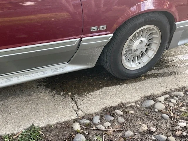

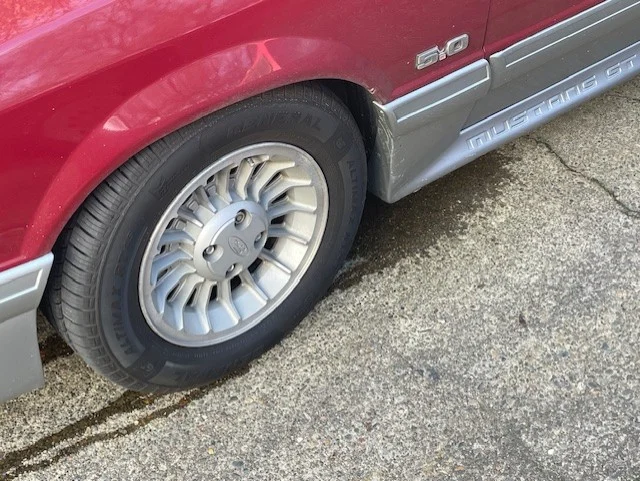

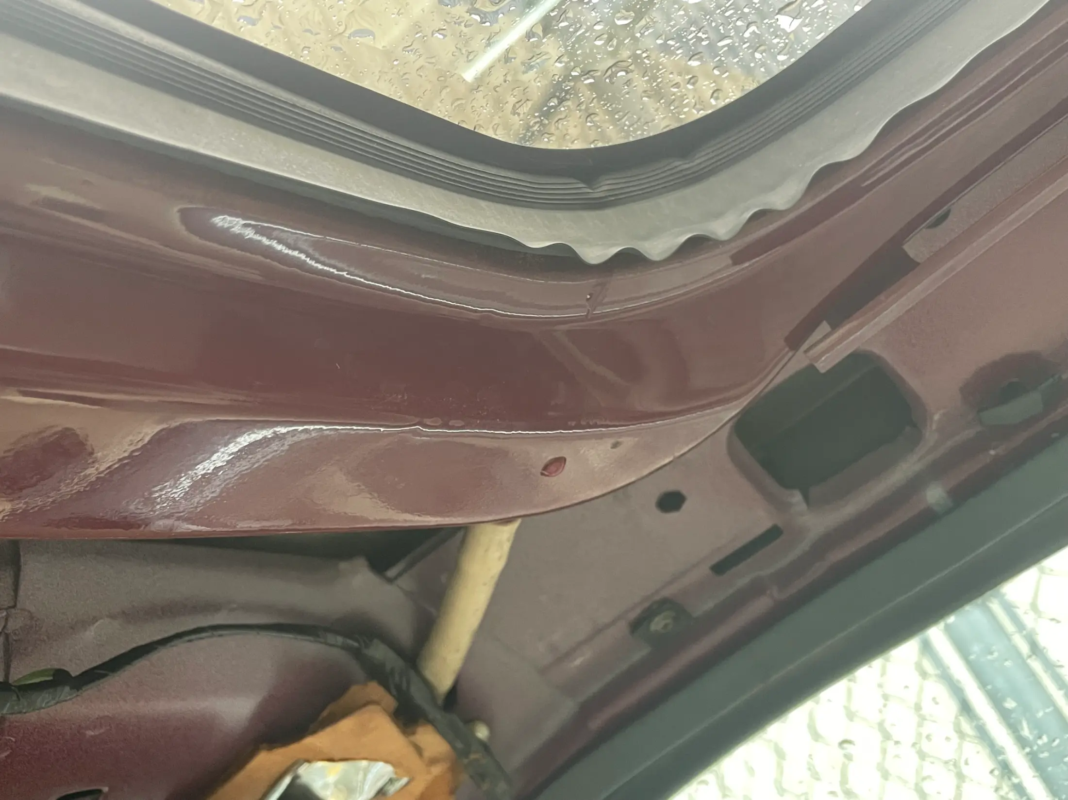

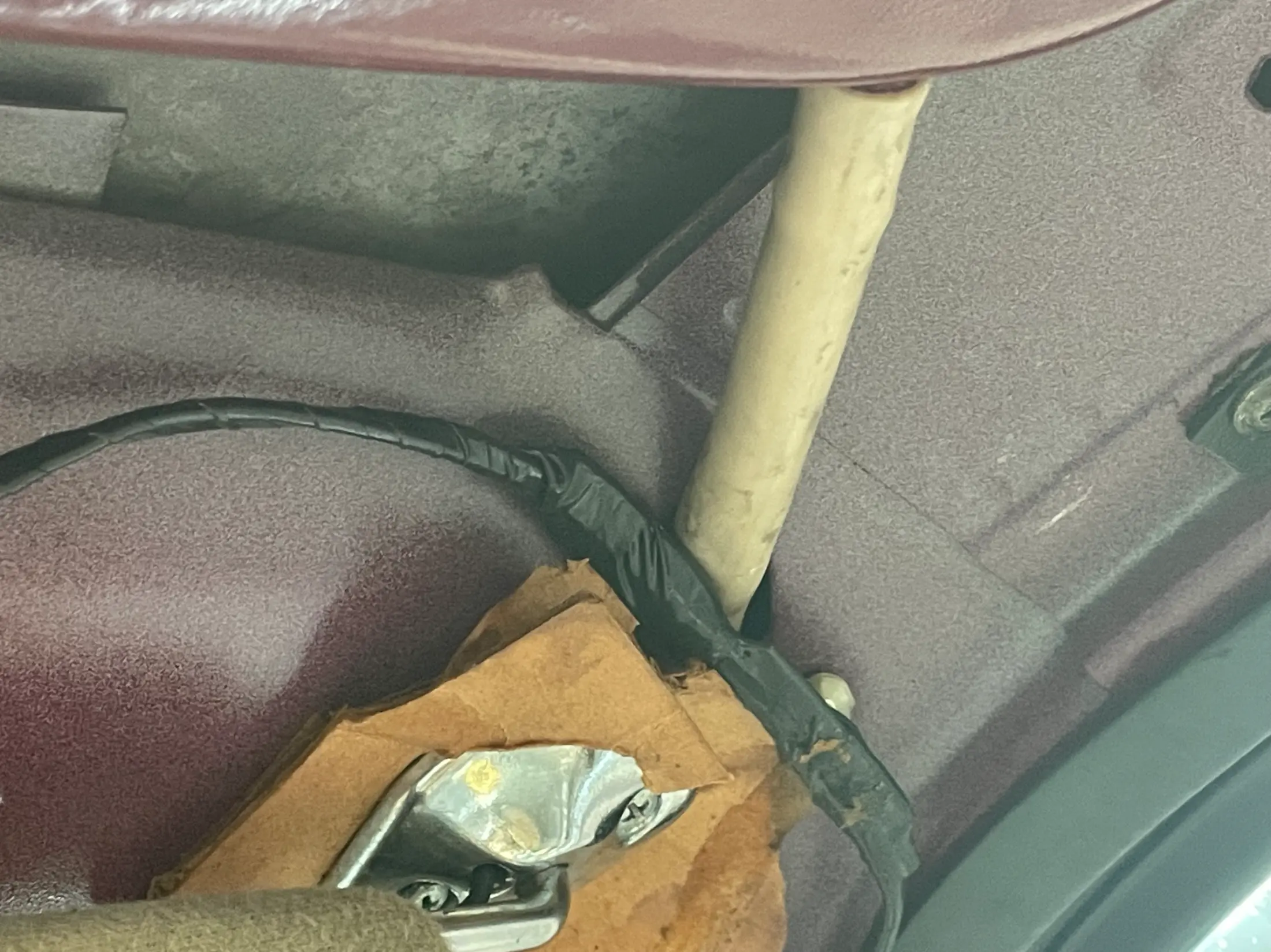

Hey guys, I have not been on here much lately. Just been driving my junk and lurking every once in a while. So the sunroof on my 89 has been leaking for probably a year now. It started to leak every once in a while but last fall it has been constant. It only leaks in my driveway and only when I back in( my driveway is sloped) It leaks on the passenger side. Water is coming up underneath the seal. I can see it. I blew the drains out and nothing is plugged. I then thought the tube was kinked because the dome light wire runs right by it. No that was not the issue.
So my question is if the body gasket needs sealer on the pinch weld channel thing? Or is it leaking because there is no headliner material on the pinch weld currently. Or does the glass need adjusted? Glass seems to sit flush height wise. The reason I ask is once the weather is nice, I want to put my headliner in. At the end of the summer I stopped by SMS fabrics and ordered some headliner material. Nice weather got away from me before I was able to glue it down and install it. Now I am glad it did or it would probably be soaked. I have a new body seal, I think it is a dennis carpenter from years ago. Seal currently on the car is not OEM either. The friend I got the car from changed it years ago when it was leaking thru the yellow plastic retainer things that poke thru the body.
I want to stop the leak so I know it is watertight before I put the headliner in. The headliner material was not cheap. Any thoughts or insight would be appreciated. Thanks

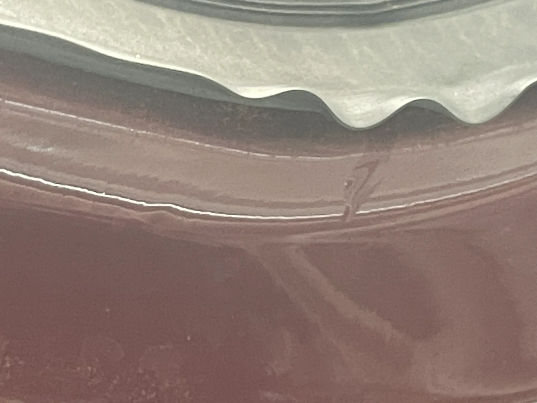

Here are some pics. You can see the drip.

In your image, the water does not appear to be coming from over the seal, it looks like it's coming from under it.
Check the drains first before anything.
That is correct, it is coming from under the seal which is why I asked if sealant is needed under there. Not sure what the factory did because I did not remove the headliner nor replace the original gasket.

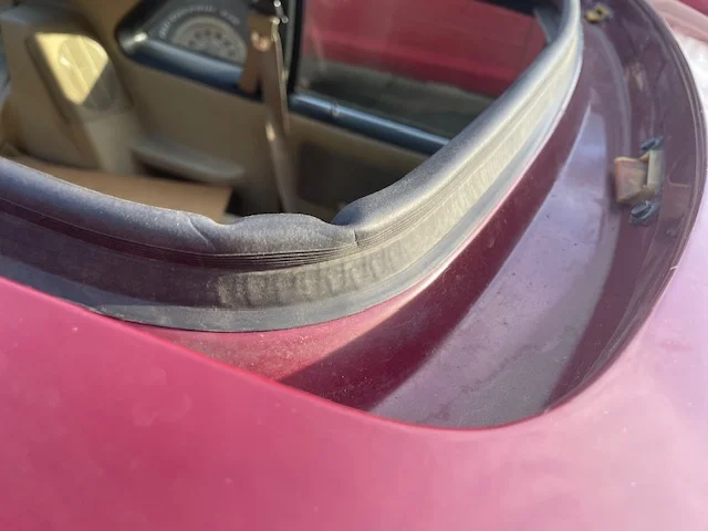

Something seems off about this seal. The ribbing and the ripples. Doesn't look like mine at all and i'm running the same DC repro seal.
Honestly, I do not know what brand seal this is. I am pretty sure it came from LMR though 15+ years ago. My friend changed it when the sunroof first started leaking but that leak was from the yellow plastic retainers.

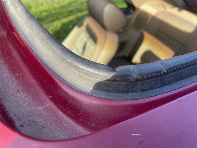

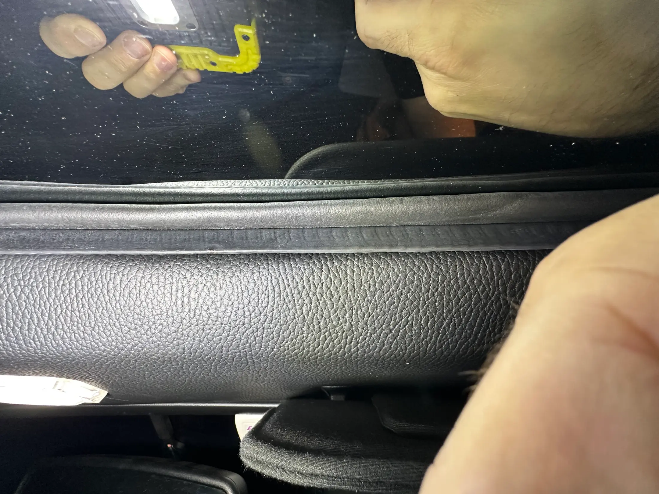

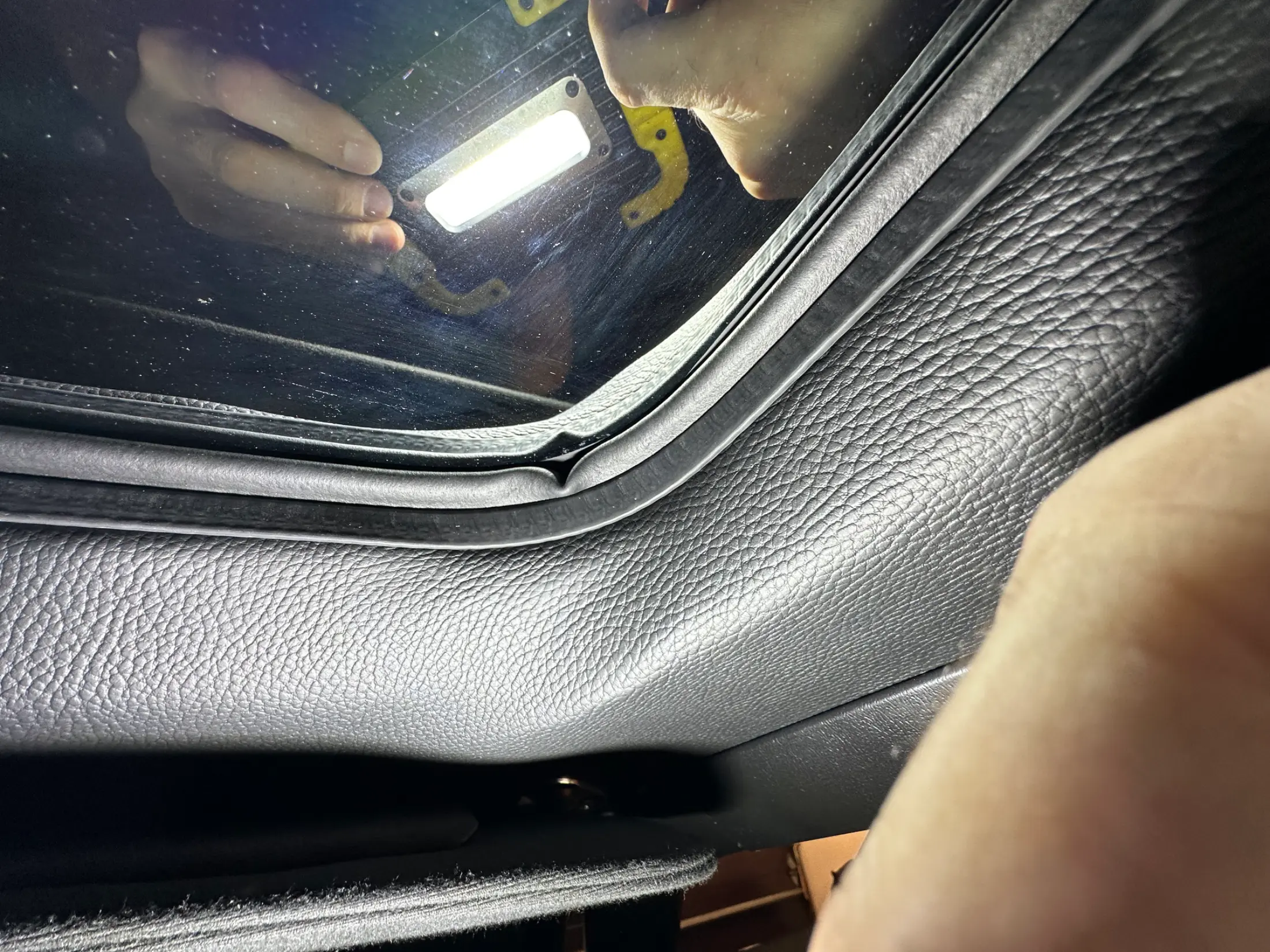

Here’s how my seal looks. Aftermarket, so doesn’t sit perfect on the glass, but it grabs the headliner/roof pretty well. Pretty sure this is the daniel carpenter brand seal
It's a lot more "finished" looking where it grabs the metal lip/headliner. Has a rounded edge. Compare to the pics in the original post.

Thank you for posting the picture I think I figured out why it looks different to you. It was installed backwards or inside out. What you were seeing on the inside of my car was supposed to go outside in the channel. This may be why it was leaking. I flipped it around and this is how it looks in the channel now.
