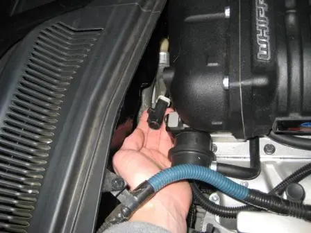

also we noticed that a plug called a thermal connector..something was unplugged...we we're confused about that also cuz the instructions aren't clear about it. That doesn't have to do anything with "not starting" does it?
Heres a picture of it

Dunno about that, but it will probably be an issue at some point.

That plug you showed a pic of looks like the plug that used to connect to the old charge motion control motor. That's the electric motor (tiny) that controlled the butterfly plates in the old intake assy. They have you disconnect that and leave it disconnected because your new Whipple intake manifold doesn't use the plates.
