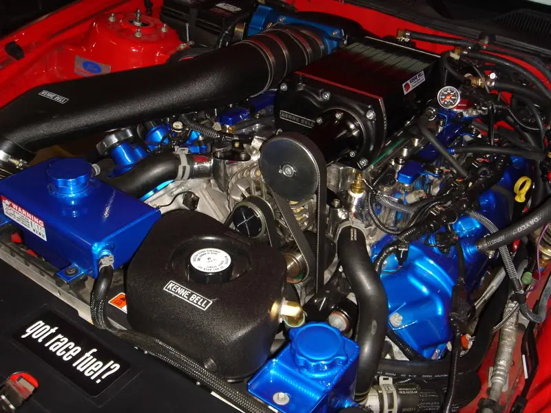

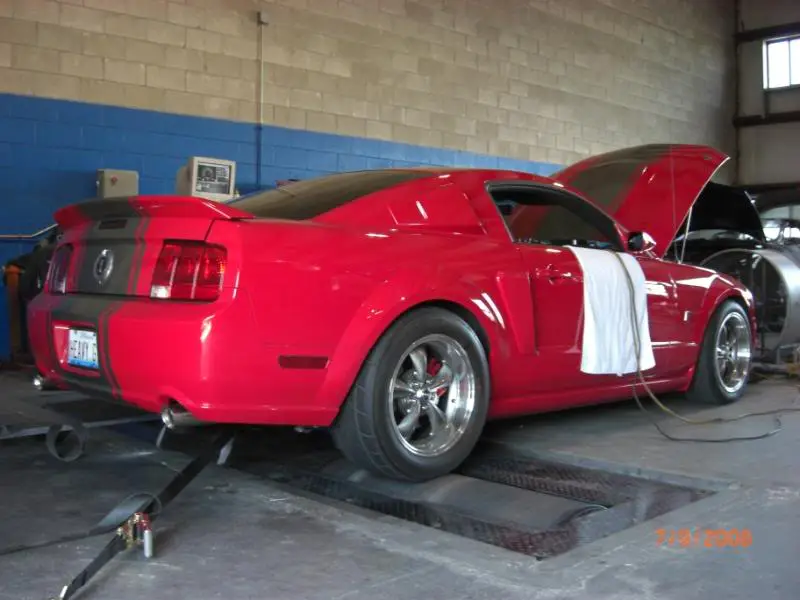

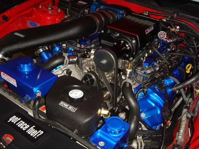

I vote for a Kenne Bell blower...but I am biased!

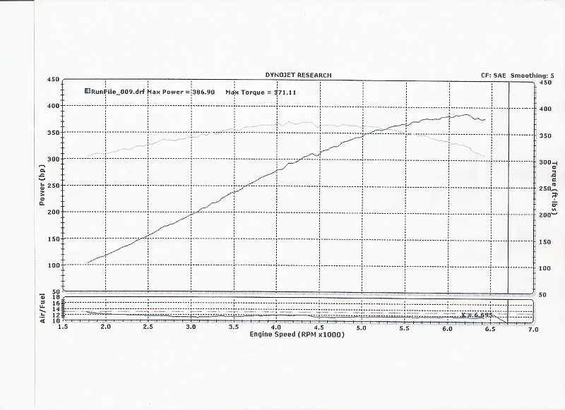

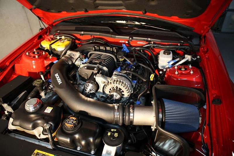

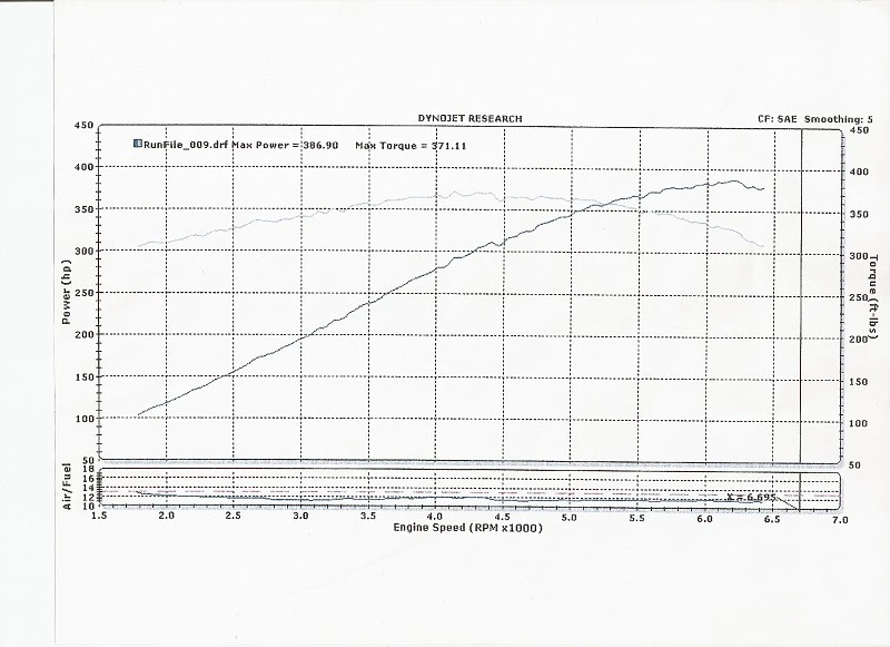

I bought a VERY lightly used Roush 445 on Ebay...just got it all installed...making 387 HP and 371 Torque...that is SAE. That is with a 2.57" pulley and a steeda Cold Air Intake.
There are going to be lots of those used available, as many folks are upgrading to Kenne Bells or the new Roush TVS.
If I were buying new, I'd look at a nastier setup than what I've got...I'd shoot for 450 at the rear wheels. That was my original goal, but my Ebay deal was too good to pass up, and I'm all about bang for the buck.

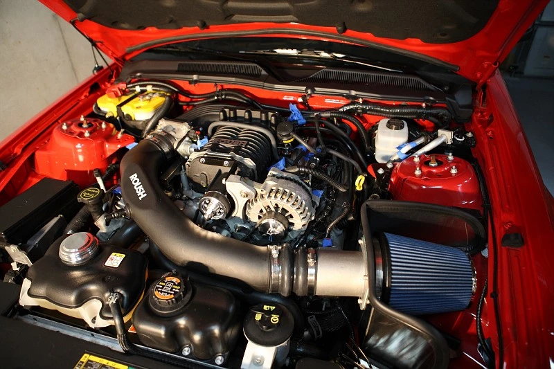

I'd probably go with the Roush TVS. It is a nasty sucker, fits great, and can put down 800 horsepower to the rear wheels if you have a forged bottom end and a fuel pump that can handle it. :shrug:
