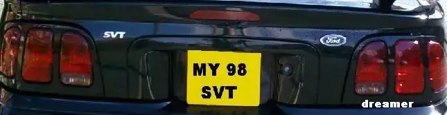

Those are some wicked bad Photochop skillz you've got there.
:D
