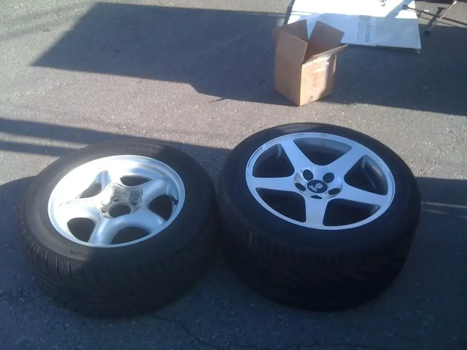

yesterday went out and got some new shoes 17" 2003 cobra's machined finish 17x9's in the front with 275's and 17x10.5's in the back with 315's. absolutely love them changed the whole look and feel of the car and they fit havent noticed any rubbing yet. these are a huge improvement over the stock 16's the car had with 245/50's all round which were pushing 3 years old and VERY hard. ride quality improved very much with the new rubber

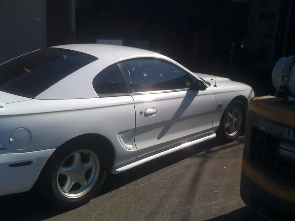

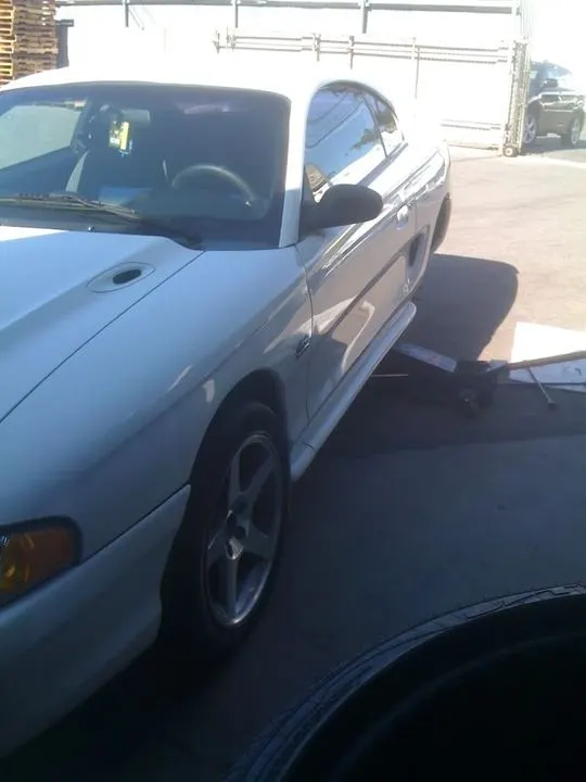

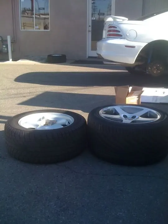

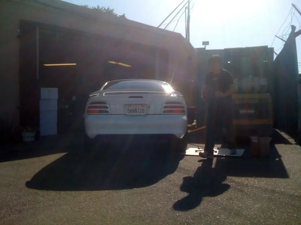

here are some pictures
First two are from around halloween of '08 with the engine thats seen much better days
And the rest are from yesterday's wheel swap
can get any opinions on this kit and how it will affect the ride quality based on my goals for the car? thanks in advance and sorry about the long post!
